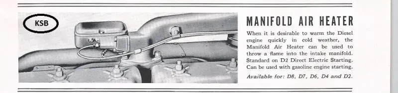

Venco 2003,
There is a photo of what ccjersey is referring to as a “Flame Thrower” from Caterpillar for the earlier tractors and engines.
Kelly
[attachment=21639]manifold air heater_flame thrower.jpg[/attachment]

Kelly, Thanks for the picture....never seen one before! The thermostarts are pretty commonly available, don't know where you could find one of the CAT units. Looking in my 5J parts book, the CAT unit really does appear to be able to throw a flame which lends credence to the legend on the picture warning that the engine must be turning! The units shown are not too different from a furnace oil burner with an ignition transformer, igniter, pump and fuel nozzle. Just takes the engine turning to supply the air.
