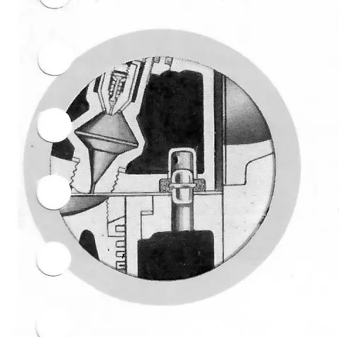

Hi Team,
If you are asking if the pre-comb thread in the head starts as a step down--counterbore-- below the pre-comb gasket seal face then I believe--from memory--that the thread can be counterbored below the pre-comb gasket seat face on some heads and not on others.
Early on engines had copper gaskets and later on there was an update to soft ingot iron gaskets on all screw in pre-combs.
Also the head castings have excess metal in some areas that when a maching process is carried out, such as spot facing the pre-comb gasket seat area, a lip can be formed due to the extra width and height of the seat area of the raw casting--the seat then appears to be counter-bored into the head.
On some seat areas the cutter will break out past the faced area and in some other parts --arcs of the same seat-- will be left as an uncut section of casting.
Scan below from a Sales Brochure maybe shows what OM was trying to describe on the pre-comb body.

Hi Team,
[quote="edb"]
Eddie B.[/quote]
Yes, the seat area in the head appears counter bored into the casting about an eighth of an inch deep. Your second picture shows that recessed seat where the steel (or iron) washer is supposed to seal. It also shows that the threads do not start immediately at the seat. That was the second question that appears to have been answered. I have seen the seat area on a D7E that was not counter bored. From memory it appeared to be a raised cast area that had a seat cut into it.

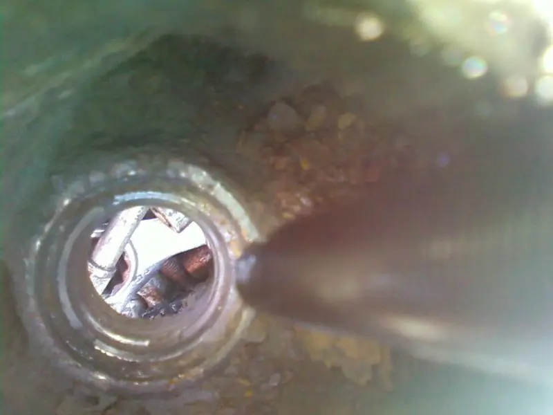

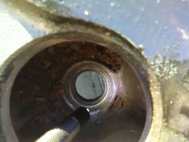

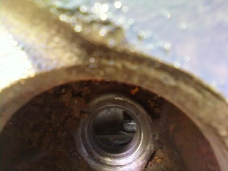

Here's some pics:
[attachment=16333]Photo035[1].jpg[/attachment][attachment=16334]Photo036[1].jpg[/attachment][attachment=16335]Photo037[1].jpg[/attachment]

Here's some pics:
Yup, confirms what you've been saying.....needs spot facing, otherwise looks normal. If there are any washer/seals imbeded in there the machine shop will soon find out.

Hi Don,
looks normal, as OM said, light might be playing tricks. Sometimes the copper washer particles embed into the iron and makes it look like the washer is still there.
Now we have the extra info that you have pre-comb style chambers, it is probable that 2 washers were fitted so as to "TIME" the glow plug holes to suit the chart OM supplied.

Reply to edb:
Hi Don,
Makes sense, but I never found a washer of any kind on #4 cylinder. I thought that I read somewhere not to stack the washers as they won't seal.
I can tell that they had high temp silicone on the threads of the chambers as well trying to get them to seal.
