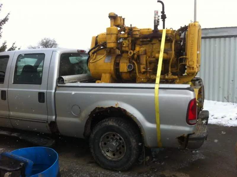

I am the proud new owner of a D311 generator. It has run for 2288 hours and will hopefully run some more. It's located in Waterloo, Ontario and is headed to Port-au-Prince, Haiti in the next few weeks.

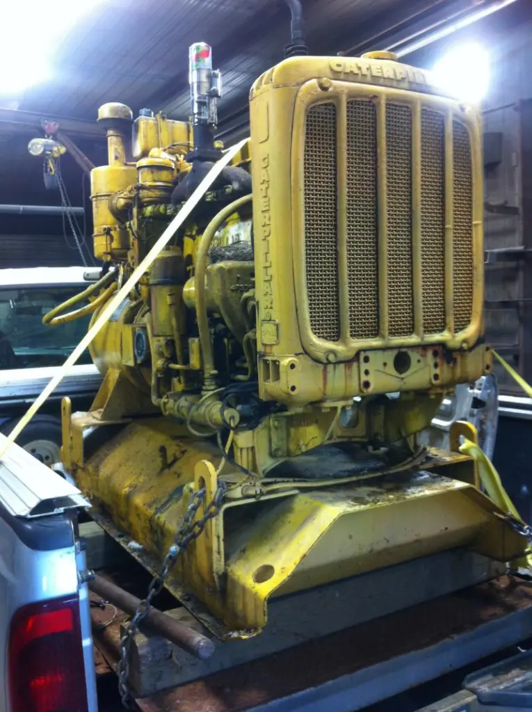

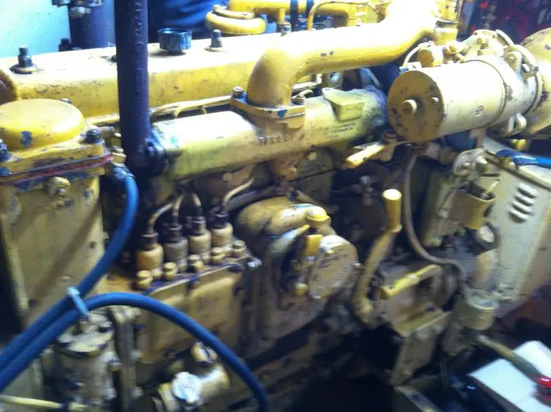

Thanks a lot for your assistance, I really appreciate it. I've attached some additional photos of the generator.

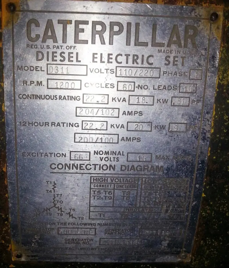

[attachment=25975]311R.jpg[/attachment]see attached data plate for my 1200 rpm 20 KW Rated unit with a 4V serial no,
I will be interested to learn your serial number
e mail or PM for the attached spec sheet in higher rez
The spec sheet also states the 3 phase unit is rated at 21 KW at a .8 PF
The single phase unit is rated at .9 PF
I haven't figured out Power Factors so don't ask 😊

The 40RLxxx generator series and 2L1819 exciter are actually the same unit as used on the D315. That's where the 30 kw capacity comes from.
Apparently you can get away with the higher rating (factory) single phase on the D311 engine.
