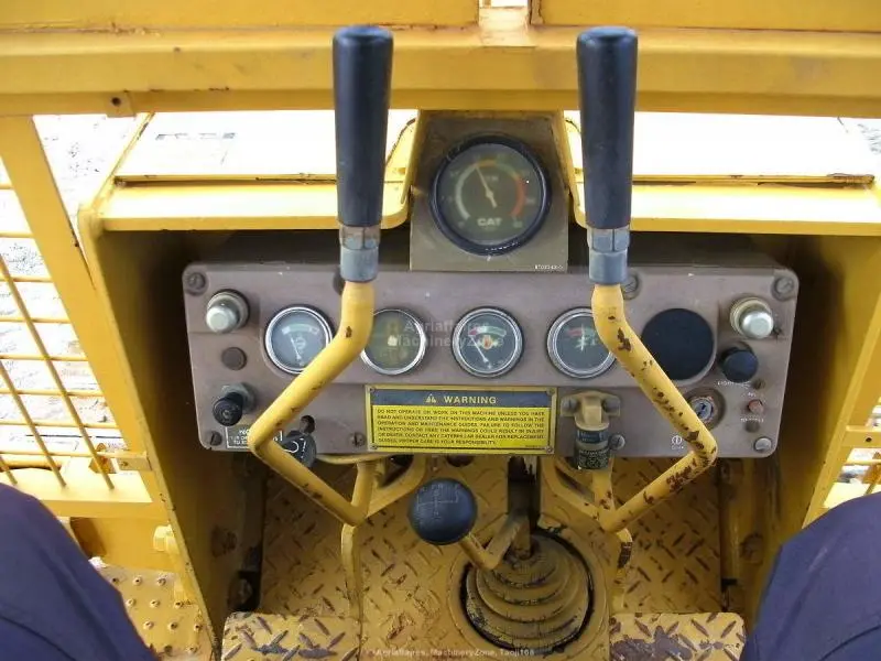

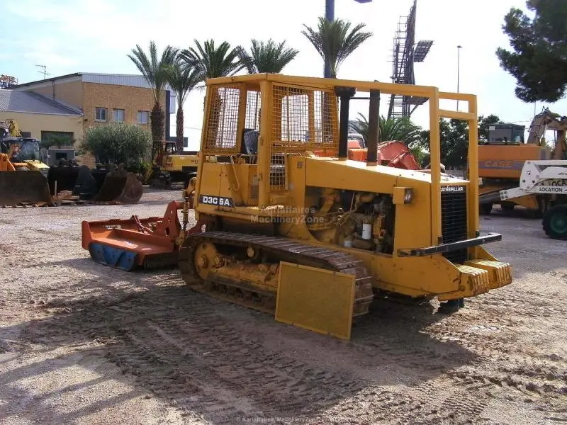

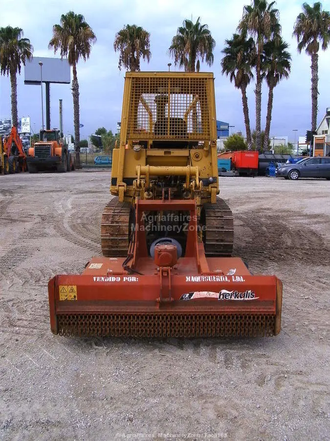

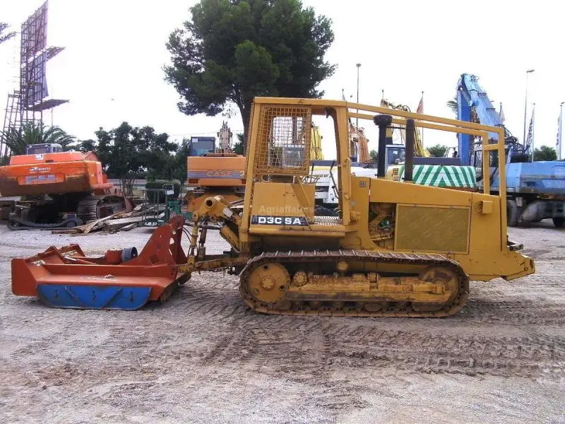

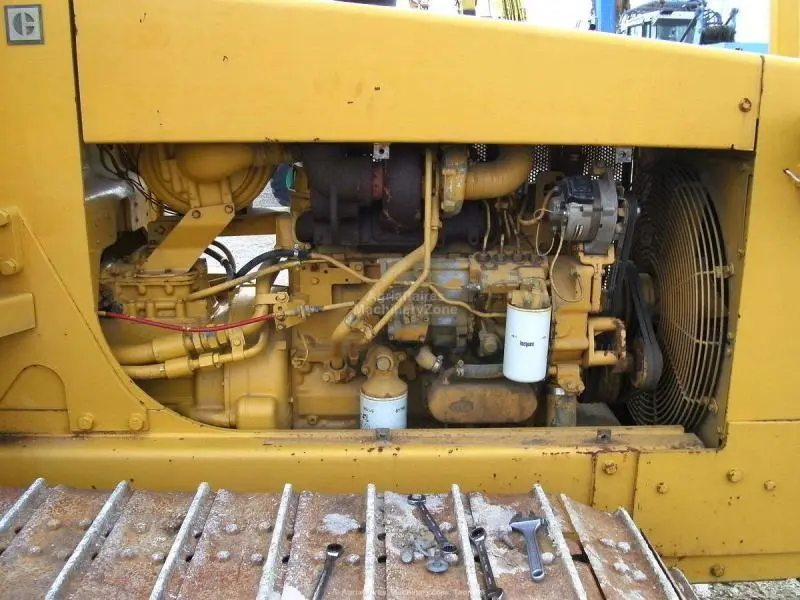

Some pictures of one for sale for 16k in Spain. Picture of right side shows forward reverse lever in the u-shape slot by the operator's left hand. I don't see a picture of the clutch unless it's a function of the reversing lever. It also shows the 540rpm pto and the 3-pt linkage. Other picture shows the 5 speed gear shift in the center between the steering pedals. I didn't realize this model from 1990 was turbocharged - I wonder how many hp.

The D3B 2PCxxxx SA, LGP has a turbo 3204 direct injection rated at 82 DBHP and 101 engine hp. and were produced from 1985 to 1990.
Even rarer is the extra drive for either a winch or pto.
Regular D3 3204's are all 70 hp.

I too have never heard of these models. Were they built in Japan or Europe or somewhere besides in the US? Those pictures look "foreign made" to me. I wonder if it has a foot clutch pedal? I see the forward and reverser lever Neil mentions but it looks like a clutch would be needed somewhere in the controls.
