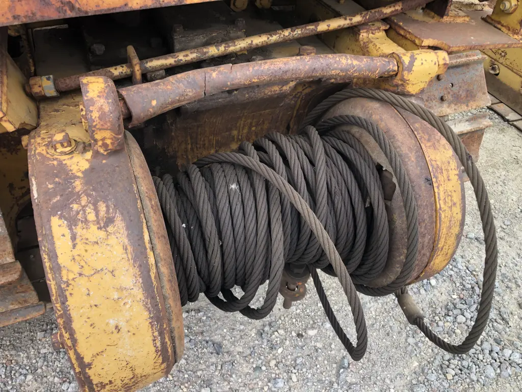

I have a D2, 5J with a Hyster winch, model K R and need to replace the missing tie rod spacer if someone has the OAL I will be able to make one. Hyster part 3 32182. Thanks Joe Van.

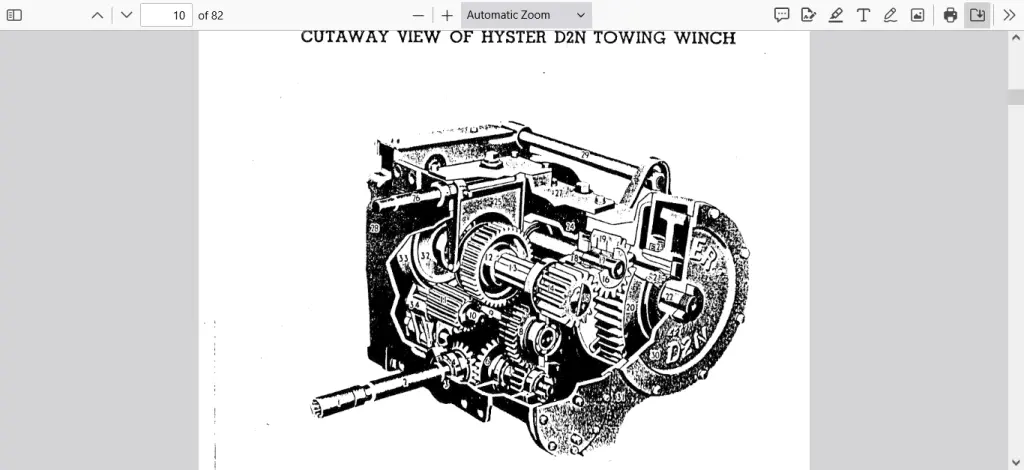

Item 29 --- the pipe spacer and stud between the two winch cases to stop them spreading apart--situated above the cable and drum as in the screenshot above which I took from the Winch manual I posted a link to earlier in the thread using the part numbers "vansgarage" gave--- albeit further down in the Parts section of said link.
