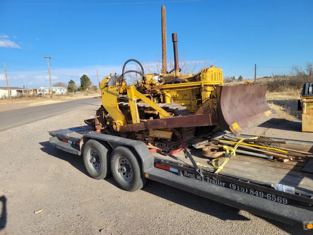

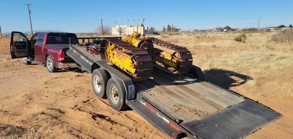

Figured I would share some pics of my toys
 [attachment=66713]received_316608100516979.jpeg[/attachment]
 [attachment=66712]b794f315b7d1daa9e3a6b452f2518849[/attachment]
Tue, Feb 8, 2022 3:45 AM
Thanks for posting, love the photos. You should tie the machine down better, looks like the engine blew off! 😉
Tue, Feb 8, 2022 4:45 AM
mjspicer1980
Send a private message to mjspicer1980
Posts: 16
Reply to Kurt Bangert:
Haha. That's funny. I didn't think about that. Good thing it's 2 different dozers.

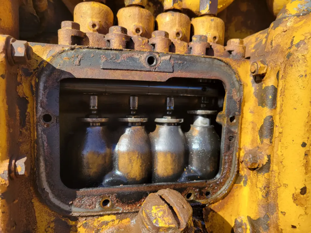

Okay. The pony fouled the plugs. Main engine still won't start. I gave a squirt of ether and it started and then died. Watched squatches videos and seen him get a 20 yo d2 running. I popped the injector pump Inspection cover off and turned the engine over by hand. The rear injector lifter is sized in the up position and the fuel control rod won't actuate back and forth.
Who knows about injector pumps.

Reply to mjspicer1980:
Pic of lifters
Sun, Feb 13, 2022 11:51 PM
Posts: 2,763
Pic of lifters
Start spraying the injector and control rod with loose juice--let it set a couple of days and then gently pry them to get them to move and then work back and forth
