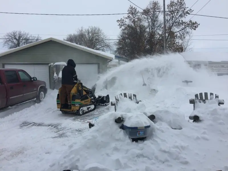

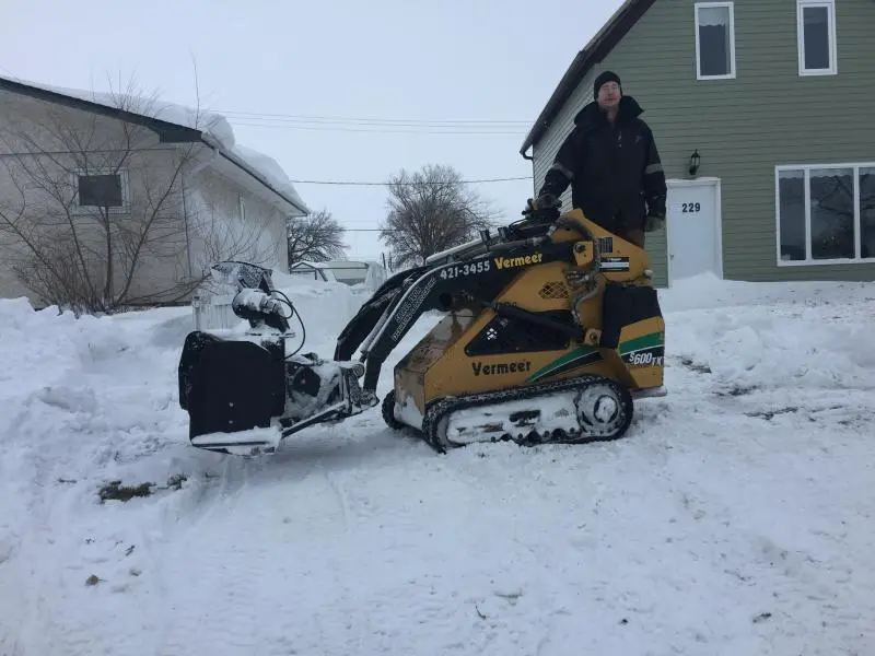

thanks guys for the input. from what you guys brought up i had over looked the ground speed thing. plan was to hang off the draw bar at the back then run the frame to the front where i have a way to lifted it. but with not having live pto it's going to be relay hard to slip the clutch to get a little to lower ground speed. unless there some way to changing speeds? smaller drive sprockets? going with a all hyd drive would need a huge tank and lost of gpm pump, oil cooler and big money for the pump and motor and valve. you got to remember this is NO budget holdings we working with. lol i have done one for a small skid steer it's over 40 hp works good but hyd oil sure gets hot it was a lawn mower one we made work on the skid steer mostly used for doing sidewalks. guess that's why it's not done. thanks guys for the sounding board sure is nice to have you guys to point out what i missing.
