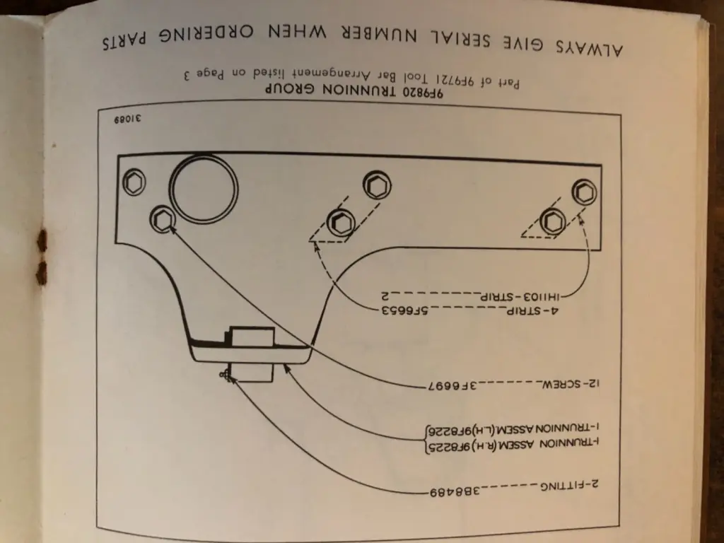

In my quest to stay busy with yellow iron projects, I have decided to mount up a spare tool bar set up for one of my D2s. I noticed that the trunnion holes have a taper. The correct CAT part numbers per the book are 3F6697. Are these bolts still available anywhere? Or has anyone used a regular grade 8 bolt and found a taper lock similar to those on a semi truck axle to make do?
How about the "strips" seen in the book? What is/are the purpose? I am not understanding what for, and do not recall ever seeing any of them on any of my other machines.
There are part #s 5F4776 is that really just a flat washer? Then I see 5F6653 and 1H1103; are these really just shims?
Sorry for the lame questions, but I just soon button this up correctly the first time, rather than have issues later.

Tapping strips (not shims) are for use when the track frames are not threaded for the attachment bolts.
I'm not aware of any taper locks for 3/4 NC bolts.

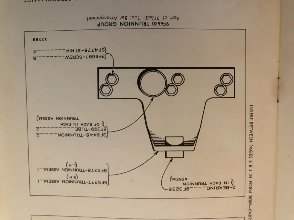

Photos from my parts book: The “long” strips look to be for a D4 track frame for whatever it’s worth.
Thanks fellas. JM

3F6697 Bolts are still available, it’s be awhile, but I think Cat wanted $15 each..... I got a set from NorCan Parts and Equipment in Spokane, Wa. They were aftermarket, cost was somewhere in the $7 range when I brought them. They had to order them, as they don’t keep them in stock. My D4 7U had the threaded holes in the frame, still had the cork in the holes...maybe early D2’s were just a hole ??? Then the strip w/ nut, would make sense on the backside of the frame. Would be easy enough to make the strip w/nut
I see where you’re going with the 3/4 bolt and the cone washer idea.....thought of going that way, til I found the bolts at Norcan.
