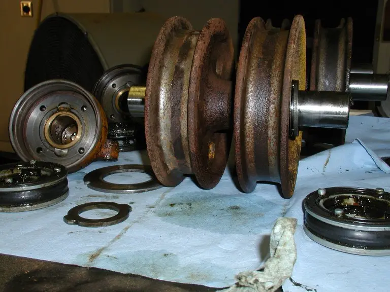

This is a picture of one of my D25U rollers I had to replace. The lower edge of the picture shows the old bellows seals. Hope this helps.
Have a good evening...Bill
