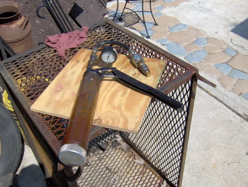

this rig works good for me. I got the button head fitting adapter from cat. A
person might be able to get one from lincoln also. I keep a eye on the guage
as pressure builds up then let the pressure drop then another pump cycle.
the better rollers will hold 200 psi , others won't go past 75. I'd take the #'s
with a grain of salt and rely on more on feel as pressure builds.Even the worn
rollers (less than the max book spec of .050 bush wear ?) seem to hold the grease back with only a small ammount seeping out.

Waukman, thanks for posting that picture of your setup. I'm finding it takes more pressure that I thought to push the grease to both end caps. I bought a new low pressure grease gun and it seems to work good, I just pay close attention to what I'm doing. Before I rebuilt the undercarriage none of the roller seals were any good, the previous owner said that before each use he just greased the rollers until it squeezed out to try to keep the dirt from coming in. After all the cleanup, then getting everything tight and in good condition, I'd like to try to keep it that way.😊
