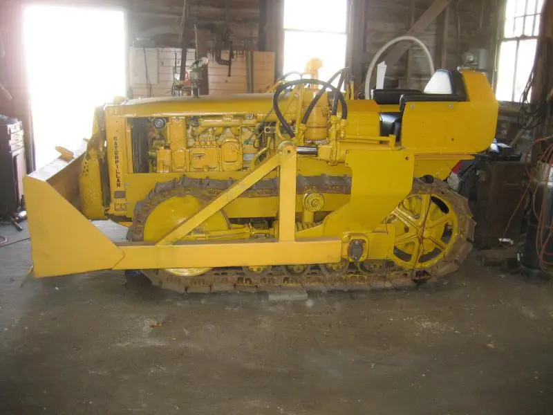

will need the serial# of the machine--then i can check the part #'s and see if they match my 4U, then i can measure the length
[attachment=21288]242.jpg[/attachment]

Ok--they are called track roller frame guards--unfortunately the early U tractors had a different part no from the later U tractors--the early right side were 6B2311 and 6B2237 , and the later were 3h5047 and 6b2237---don't know if the rear ones were the same length
