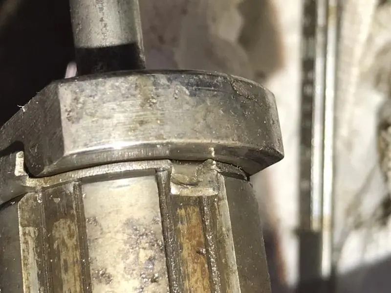

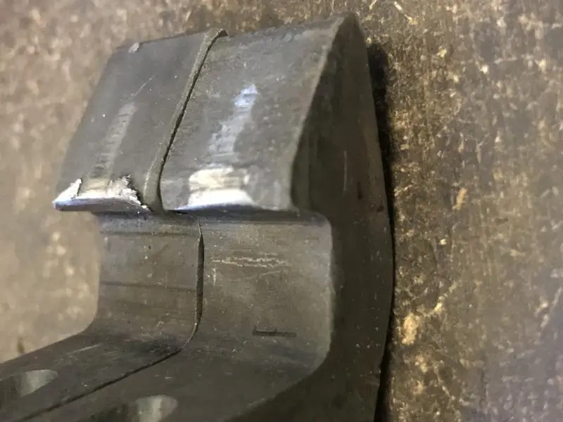

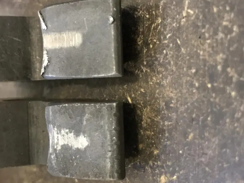

Since I’ve owned my D2, I’ve had to hold the starter pinion in gear until the Diesel engine starts, and if I let go before it starts, it disengages. While I have the pony out being overhauled (waiting for my block and crank from the machine shop), I figured I might as well go ahead and fix it now. The stop appears to be in good shape, and looks like it may have been turned over at one point. The latches look worn to me and I’m probably going to replace them. I’ve attached photos for anyone who wants to chime in on whether or not they should be replaced (I know they’re not cheap but want to fix it right).

I would just preheat the worn spots and weld them up [latches] with 7018 and grind back to shape.

Thanks Rome. That's a good idea, but I don't have the capability to do that at the moment. I went ahead and ordered from Florin.

I robbed this off a post some time back and it gives the dimensions for one of the latches. I had problems with a pinion several years ago unlatching and I replaced the latches and spring and that cured it. I think the face of the latch is quite critical and the dimensions bear that out. It would take a machinist with a lot more accuracy than me to weld up the latch face and grind it back. There is a slight taper to the face and I think it is quite critical. Ponys are great when they latch and unlatch correctly but otherwise can be a PITA. Bought latches in 2005 for $77 each and I believe the local Cat dealer said they are now about $250 each..

Jim - that's pretty interesting. Glad I bit the bullet and went with new ones. I believe they are 275 now from Cat, but I got mine at Florin for less than half of that.

im with Rome K/G weld them up. I dont think this is a machinist part, close is close enough especially 60 years later. Refurb and adjust properly and you'll be good to go. I've adjusted a couple and I'd start on the loose side, cause its alot easier to adjust than rebuild.
