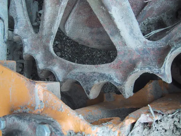

 [attachment=64366]rail notch.JPG[/attachment]Can you cut a little half moon out of the outer track frame to clear - once the sprocket releases from the taper will it tilt a bit also? Bob

Thanks gents. John, my rail is easy to undo because I have the split master pin arrangement so that's not an issue. Did you remove your main spring as well like Scott did? The J-series might have a bit of different geometry if you could leave the spring set. In any case, I'll give it a try first to see if it's possible, but it's not a huge deal to remove it, particularly because every single nut and bolt on this machine has been refurbished. I'm not averse to trimming the back of the frame where it doesn't compromise any structural integrity.

looking at the picture posted it appears there is a circular arc cut into the inboard track frame.   i wonder if the frame can be pulled outward off of the shaft in order for the sproket to clear?
Yes -Built a new track frame so did not remove sprocket so made the circular cut.

Restore, if you cut the frame, how much do you take out, and how much do you have to lift the frame with the cut made?
