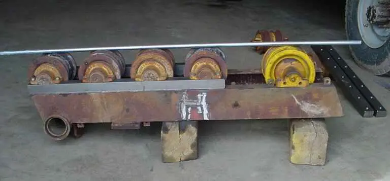

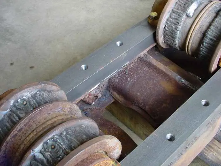

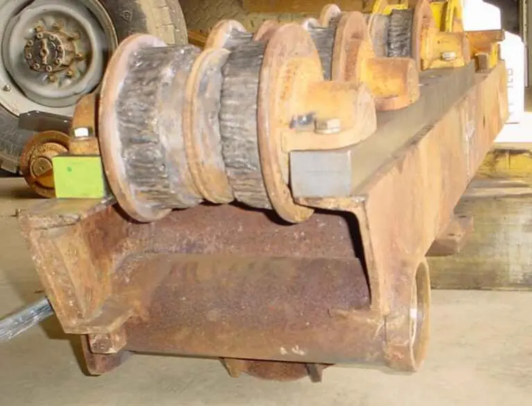

I believe F P Smith has new ones but I made the spacer bar and used the sealed D3 rollers and built them up with 1 pass of 7018
Note in the first pic the roller on the right is original D2, the ones on the left---on the spacer bar are D3
One thing to change is you need to move the back roller forward for sprocket clearance as the D2 rollers are hollow in the center, the D3 rollers are not
