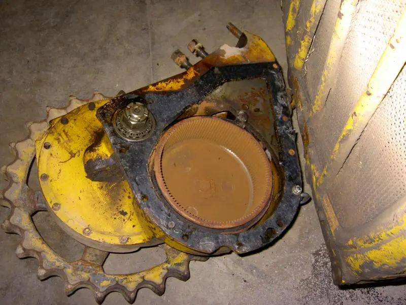

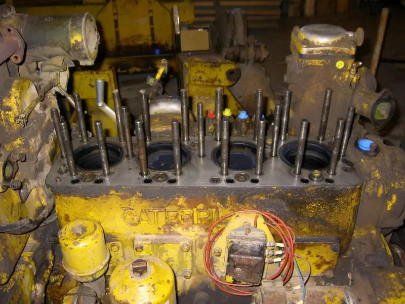

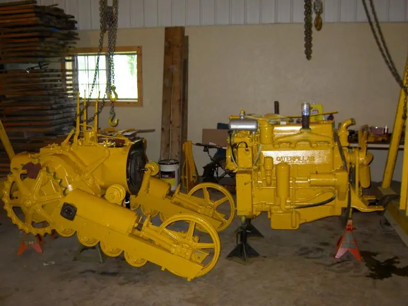

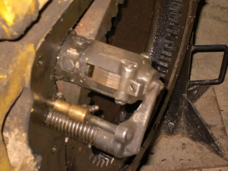

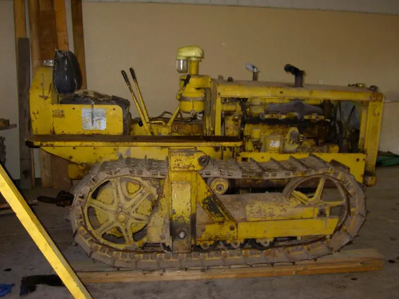

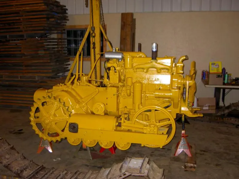

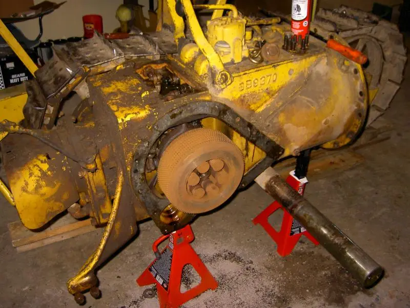

Getting the D2 put back together after new steering clutches, main clutch, head gasket, pinion bushing repair, pony carb and fuel tank, and some paint.
Thanks, to everyone that has helped with parts and answering questions along the way!!!

Andy, NICE JOB! you can take my D2 and work on it anytime you want to!

Great pictures, thanks for taking the time to post.👍

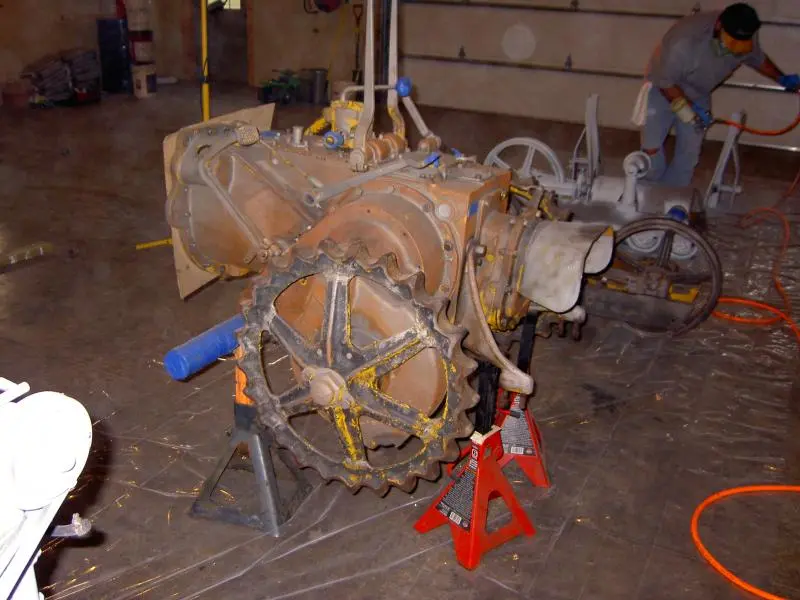

Did you sand blast the engine before painting too?
Fantastic job. It will be a beauty!
Thanks for sharing, I hope my D2 4U looks as good when I finally get her back together. I'm curious about the sand blasting too, how long did it take to do the whole tractor and did you do it yourself, or pay someone, and if so how much did it cost, and also, how many gallons of paint have you used so far?

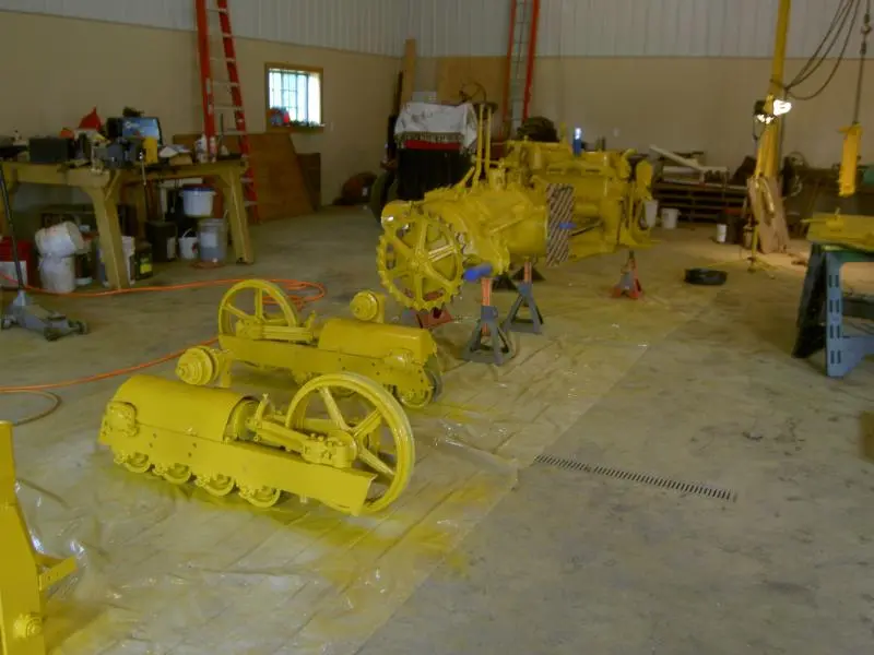

I did sandblast the engine being very careful as to where I was pointing the nozzle. I spent a considerable amount of time preping it to make sure all openings were protected and blocked off. I tried to stay away from the injection pump/governor areas as much as I could. I had the tractor disassembled when I sanblasted/painted. Engine, trans, roller frames, sheet metal, fuel tank, radiator and fenders.
My friends dad let me use his sandblasting pot which he bought for a job he did on one of his tractors a year or so ago. I followed his advice and rented a large air compressor at cost of around $95 per day (8 hrs. on the hour meter). I believe it was a 385 cfm compressor. It had no problem supplying enough air for the job. That was a huge help!
The sand I used was a product called Black Beauty that I purchased from my local Menards hardware store at around $6-$7 dollars per 50lb bag. and I used about 20 bags total. It is supposed to be lower in free silica than your typical silica sand. I made sure to use a good quality respirator. Give yourself 8-10hrs to do the job. It was a little slow for me at first til I got familiar with the equipment. My advice would be have everything ready to go so you can move from part to part. I didn't blast the tracks or it would have taken more time.
I have never painted anything before so my friend painted it for me. He had painted two tractors prior to mine so he had some experience doing that. I bought 2 gallon worth of 2 -part epoxy primer (each part is one gallon). We gave it 2 coats of primer that I bought at an autobody supply store. I don't remember what I paid for it (it was fairly cheap though). We then followed it with 2 coats of "Hi-way Yellow" Caterpillar paint. I bought it at my local Cat dealer for around $60/gallon. We used 1-1/2 gallons of paint. We also used a HVLP paint gun.
Again, I think taking my time and a hell of a lot of prep time made the job look good. It has its flaws but I am very pleased with the results.

Did anybody notice the sweet work bench in the background? It is a rops off of a D8 or D9.
