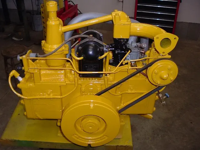

cr
Send a private message to cr
Posts: 667
Thank you received: 29
Reply to drujinin:
Thanks Garlic Pete and for the record I finally remembered the issue was on a 5J!
Here is a picture of the linkage that Garlic peat is referring to. The little tab wears out on the bottom and will twist out of the way when you go to slow it down. You can either make a new tab about 1/4" longer or build it up with a wire welder so it can't twist out of the way.
EDIT you can also play with or replace the little angle bracket that that the rod goes through and is bolted to the intake manifold at the same location.
Tue, Nov 11, 2014 3:39 AM
Dan Pratt
Send a private message to Dan Pratt
Posts: 334
Reply to cr:
Here is another view of that setup with the speed "decelerator" rod and finger.
Dan22 - 1936 22 Narrow, 1937 22 Wide, D2 5J, D4D
