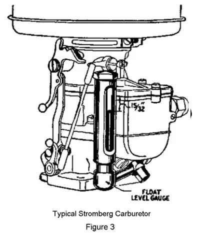

Hi Team,
Woodward UG8 Governors use something like the old Ford V8 flat head Stromberg carb tool to give an indication of oil level in the gov. case.
Something like this could be fitted by drilling and tapping into the pony sump at the inner sump base line level.
I feel it would be just another item that could break off and loose your oil.
