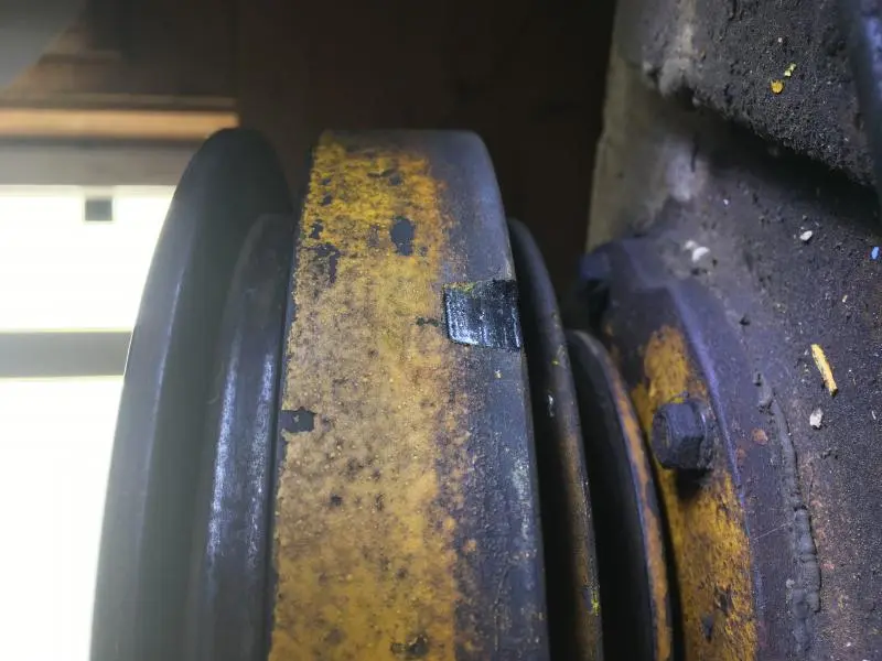

I have been trying to remove the balancer from the crank on my pony motor and the pullers slipped off taking a chunk of the balancer with it. The chunk is maybe 3/8” square and at the deepest 1/16”. Will this throw it too far out of balance and ruin bearings etc ? [attachment=50280]12AB827D-1B46-4A4A-848D-D9398C8E53ED.jpg[/attachment][attachment=50280]12AB827D-1B46-4A4A-848D-D9398C8E53ED.jpg[/attachment]

Doesn't seem like much but to compensate, just grind about the same amount of material from the opposite side and you'll be golden. To remove the flywheel, get one of those cheap 10t hydraulic pullers from Harbor Freight and a couple of bolts and heavy washers from Fastenal. Apply the pressure on the puller and then tap on the circumference of the flywheel and it'll pop off. Leave the nut on about 1- 1 1/2 turns from tight so the flywheel doesn't take off

Thanks for the advice Neil ! Glad to hear it’s not ruined!
