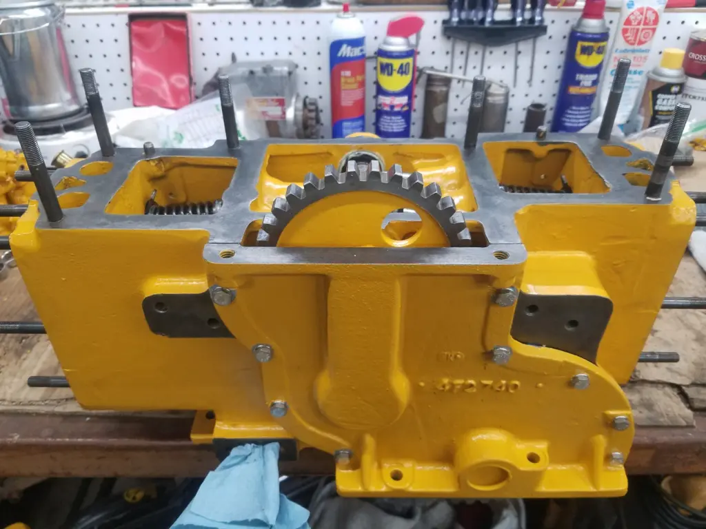

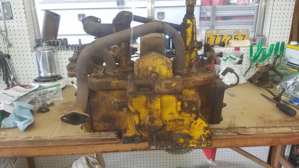

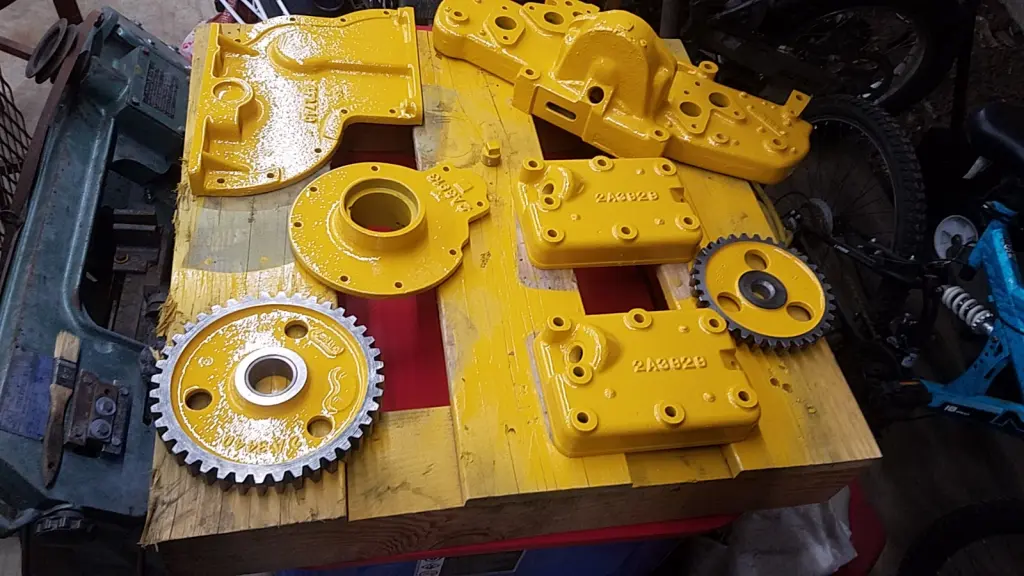

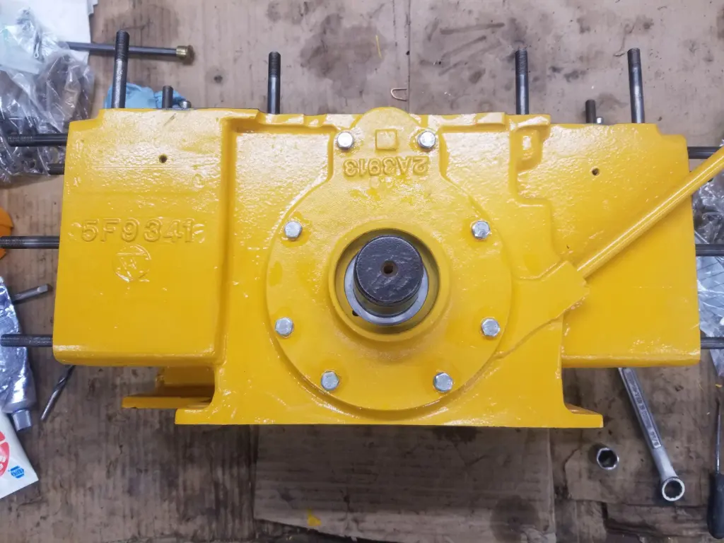

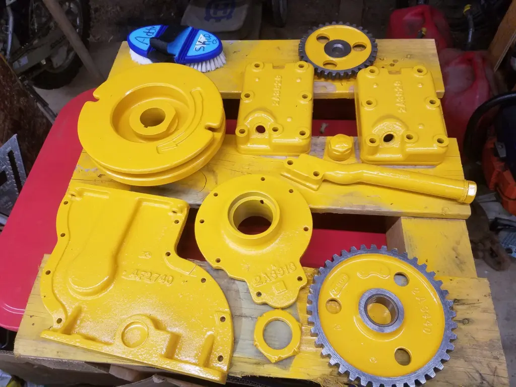

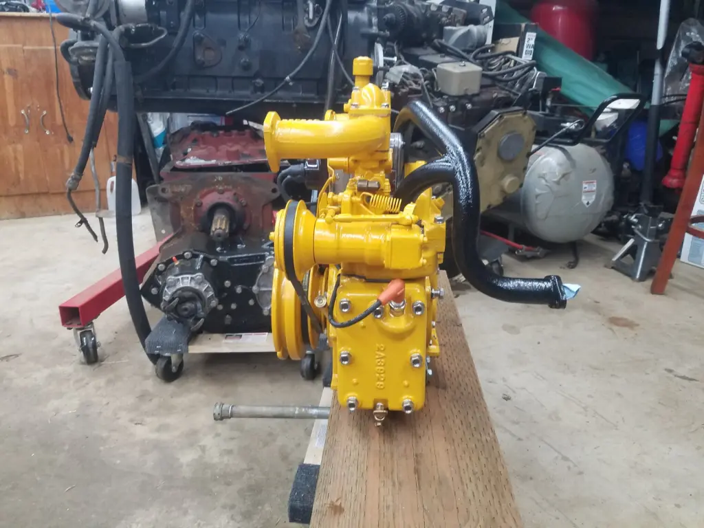

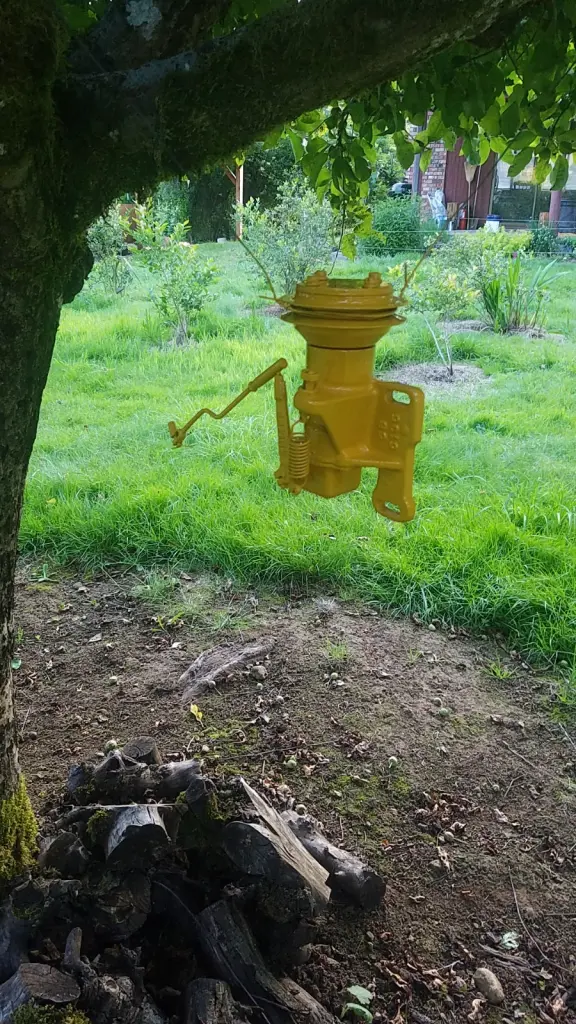

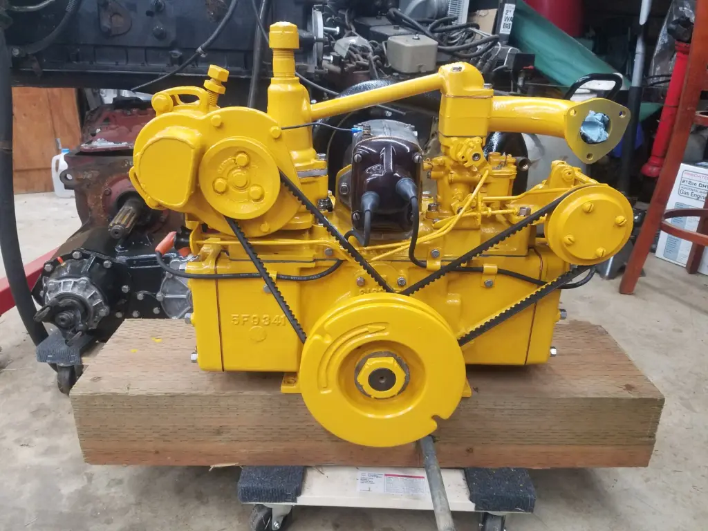

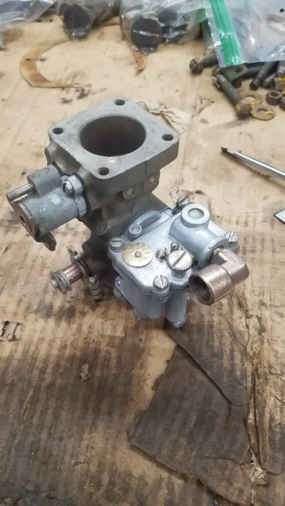

First off, thank you LSR and Squatch! After almost 7 long months the journey is almost complete. And thank you to the gentleman in Colton, Mr. Hayes! Cant remember his screen name on here, but he was a wealth of knowledge and parts, and just 20 miles from home. For you purists.....please forgive me. Its a bit of a mutt pony motor. Blending a D25U core pony with a D4 factory pony electric start, to go on a D25J. I had to have my neighbor turn some .030 under crank bearings, as I couldn't quite stomach the $400 quote from Florin Tractor. I refurbished most of the stock studs, but replaced almost all other nuts, bolts and screws with stainless steel wherever possible. Carb rebuilt. Magneto torn apart, cleaned and greased. Everything stripped down to bare metal and painted. Now just need to test fire and dial in the carb and governor. As a bit of a lurker on the forum, I must thank all on the forum for various bits of input they have given over the years. The starter pinion is the last thing to tinker with before reinstallation. [attachment=61552]20200525_170154.jpg[/attachment]

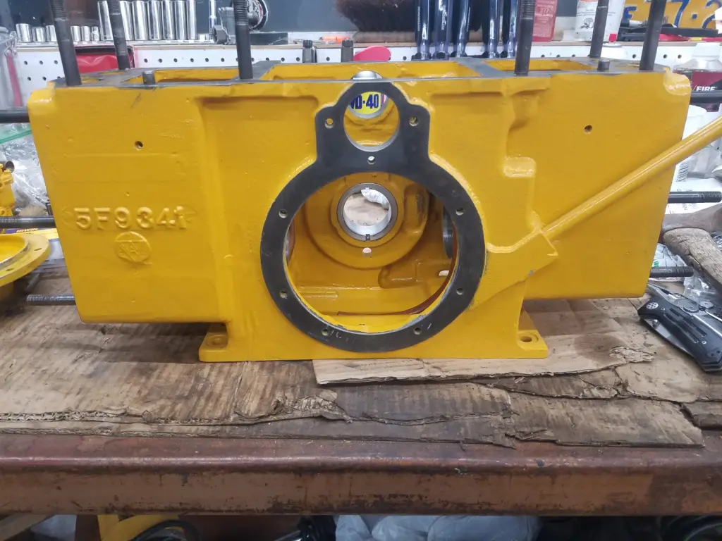

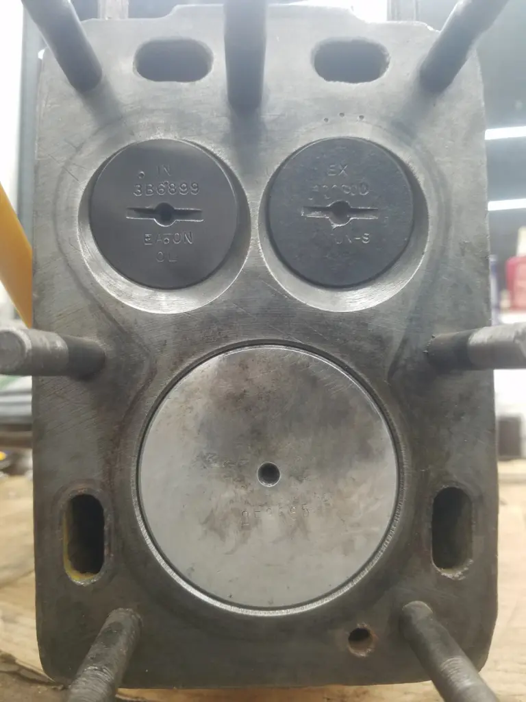

Head gaskets going on.

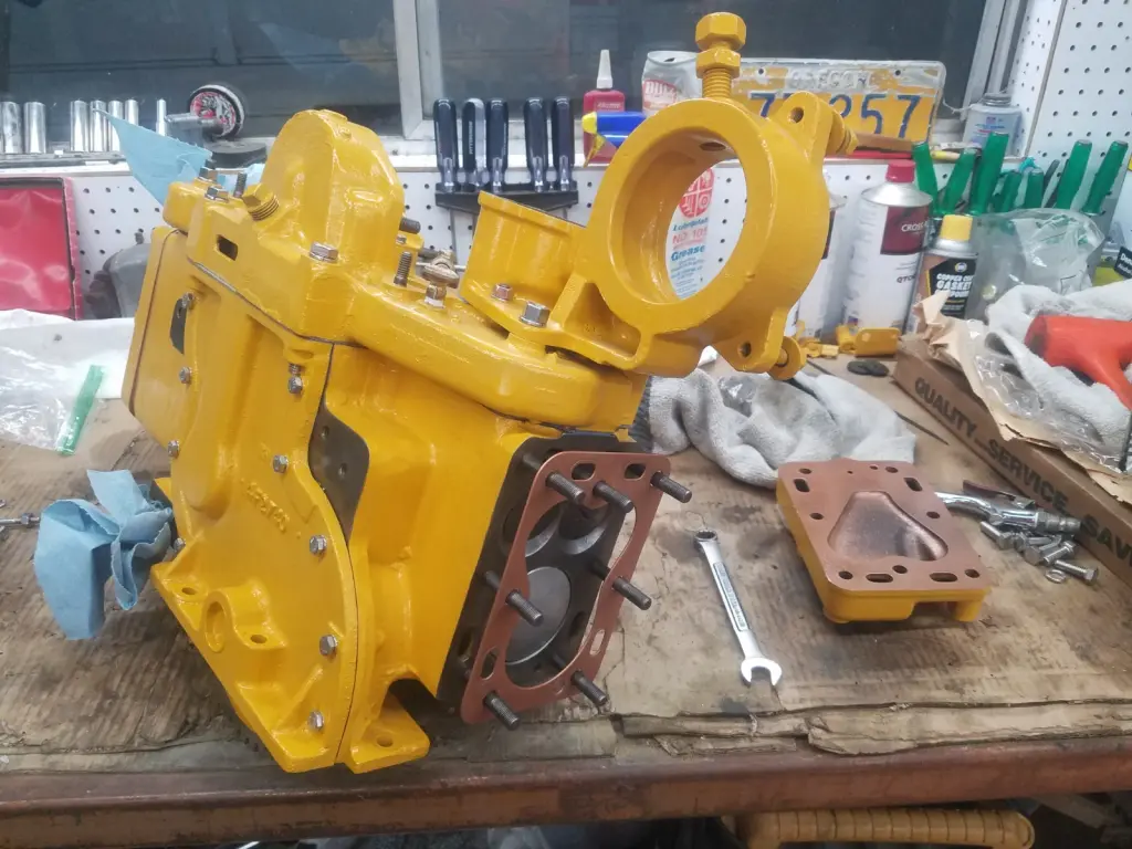

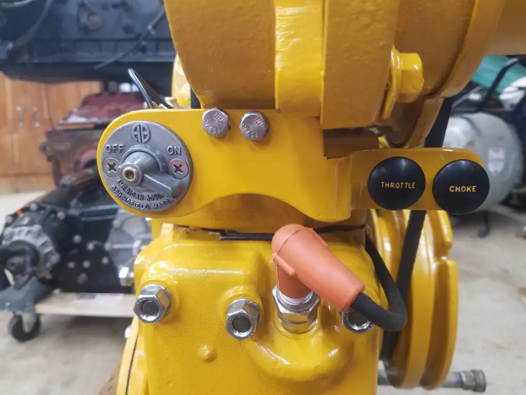

I fabricated a custom magneto switch and choke/throttle mount. And the factory electric start warranted a custom aluminum spacer on the oil fill cup, so I could maintain a one piece oil fill breather to carb intake. All in all, I'd say it turned out fair to midland.

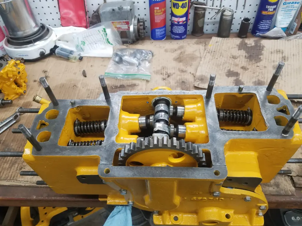

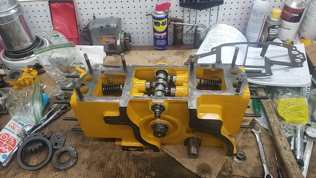

Hi Skoop,

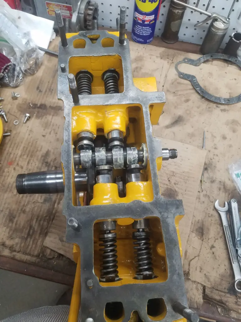

It looks a wonderfull job and congrats on getting it done, I did notice one thing that is not correct and that is the cam followers are installed back to front, the small end with groove should be on the valve stem end.
Sorry to be the bearer of bad news.

Well done Skoop, it's satisfying to get it all put back together (even if you have to take some of it apart again to fix those followers...). What approach did you use to provide friction on the choke and throttle controls to stop them moving? The OEM bracket has a spring and two nubs that bear on the choke/throttle shafts. I made the mistake of lubing and shining mine now the throttle walks its way to in. I'll have to take it off and clean it and maybe put a cross-hatch pattern on it so it holds

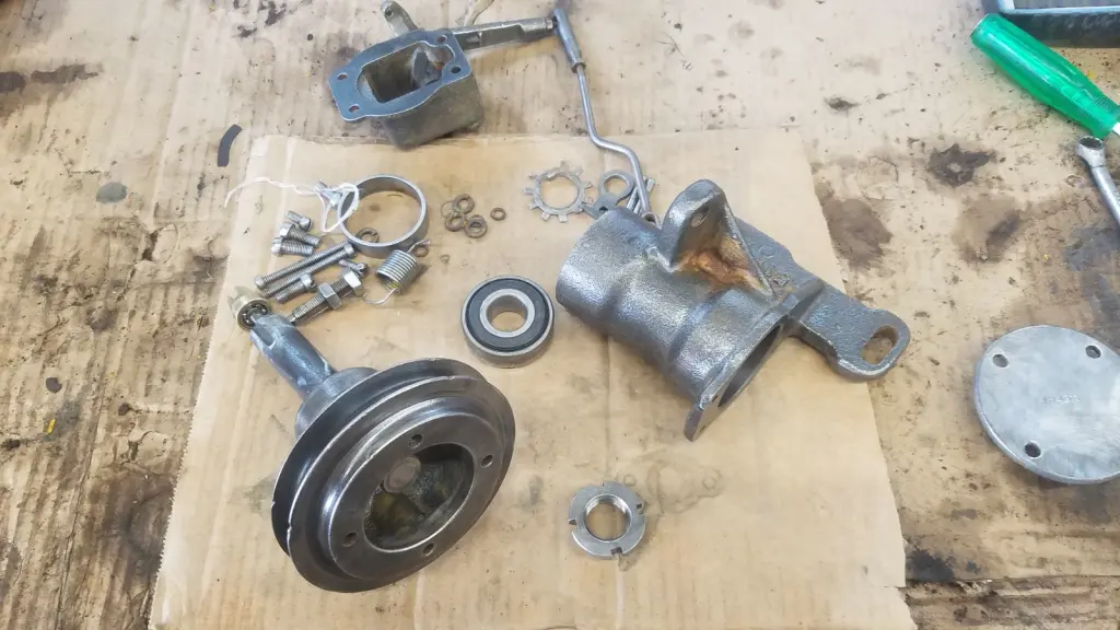

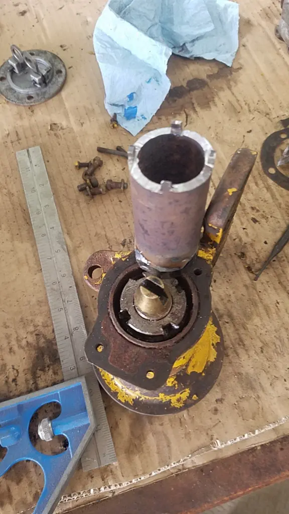

Skoop, your engine is beautiful! I am in the midst of overhauling my own pony engine too. A question for you or others. Are the governor bearings originally sealed? If not, how are the bearings and the flyweights lubed? I haven't taken mine apart yet other that take the cover off the back side and seeing the nut requiring a four pronged spanner. Really wondering if I should take it down further and how to treat it when I do. Thanks for the input!
