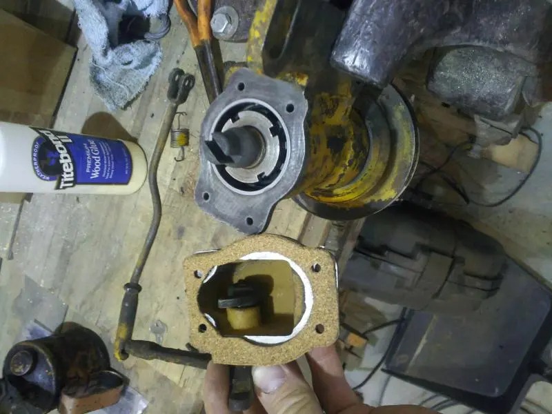

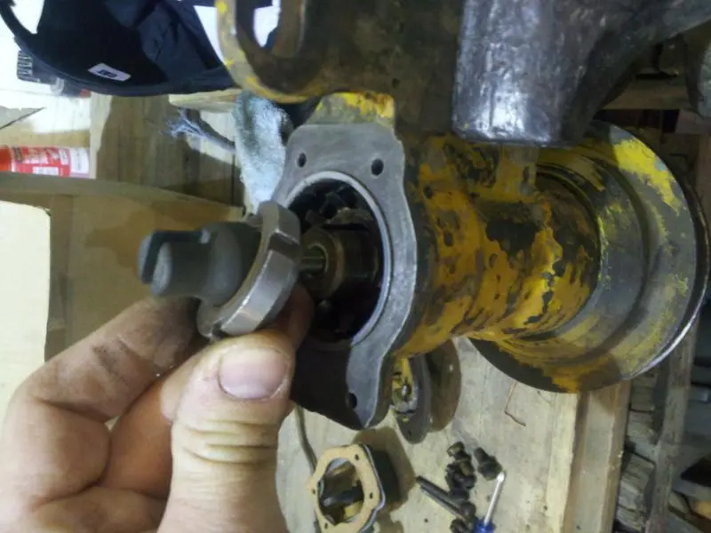

Yes It should have a little bit of oil in there, but everyone I have pulled apart never has. I put a little ATF oil in the pulley end and a little ATF oil in the linkage end as well. To get that nut off you will need to remove the slotted part in your picture. I made an attachment to pop it off with a slide hammer puller. It has a bearing inside that is a tight fit on the shaft. Once that is off you will be able to slide the rod out.
Once that nut is removed the shaft will drive out of the housing so you can replace the bearings. Last set of bearings I bought through Florin tractor parts were cheap as. If the bearings are rumbly/sloppy just replace them and be done with it.

like Billy wrote, that piece contains a small bearing that is a press-fit on the rod, so just pull it off - I think I removed my two with a couple of screwdrivers and some blocks of wood.
Billy, did you replace that bearing in the slotted piece? Just curious - I didn't as it spun smoothly but I did replace the other two.

Gday Neil.
Yes I have replaced that bearing in the slotted piece before. I had one that had rusted tight. The old bearing was tricky to remove so I bought a new slotted piece and a new bearing from Florin tractor parts.

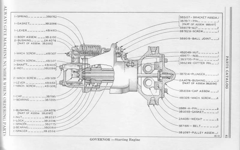

Thanks guys that is very helpful ! would you know the part #'s for those bearings The tractor is a 5u4149
The 2 big bearings are both a 3b2084. The little bearing in the slotted cap is 3b7205. The slotted cap is 3b7195.
