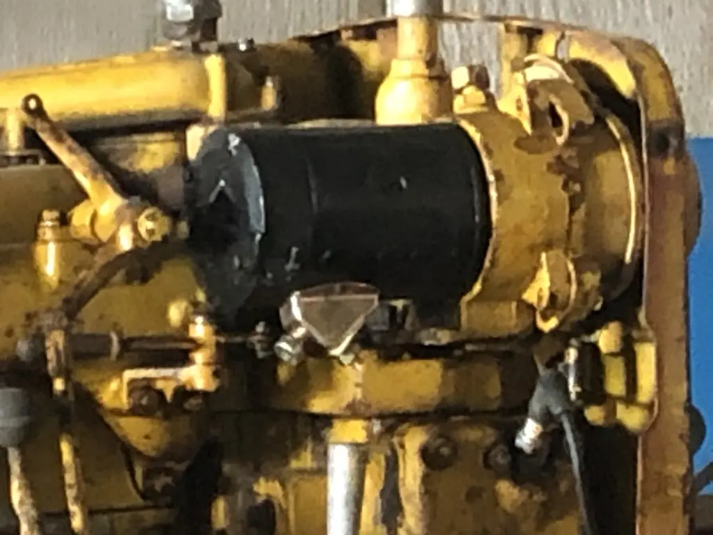

I should rename this thread “Will it start?”
I had a very peaceful day, so I installed the electric pony goodies sans mag switch.
CTS is very evasive about providing his mailing address.I have the gawd blasted crusty old rope that isn’t staying with “Lynda”. I will have to gift box it for him. JM
