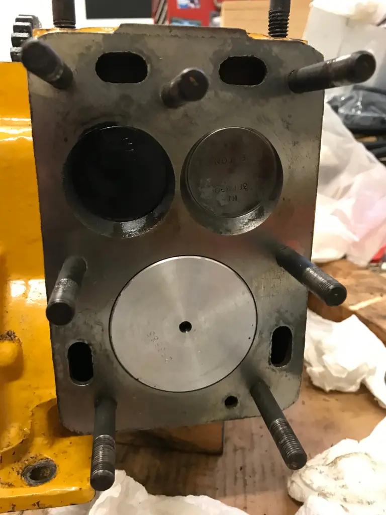

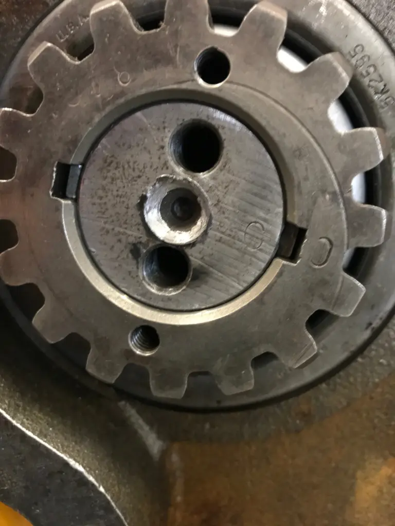

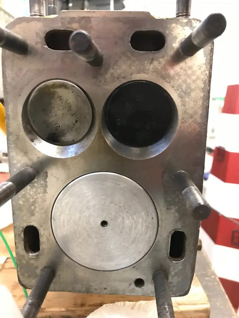

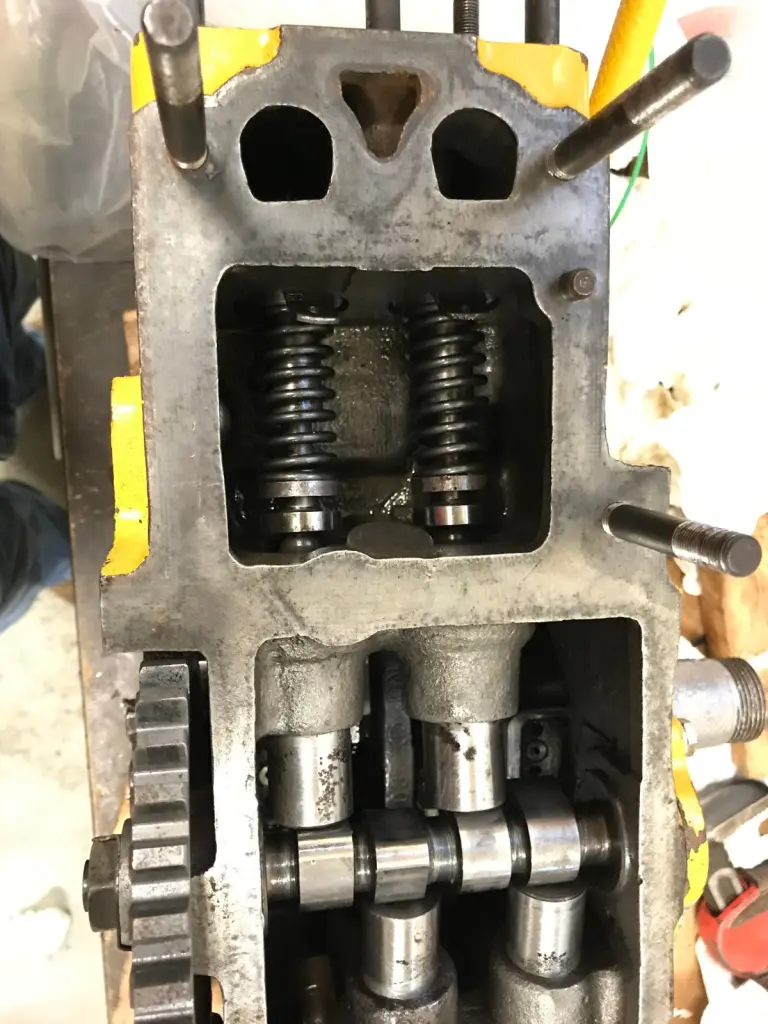

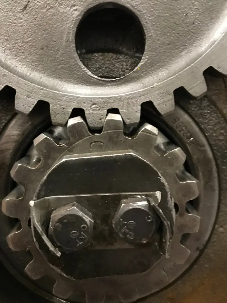

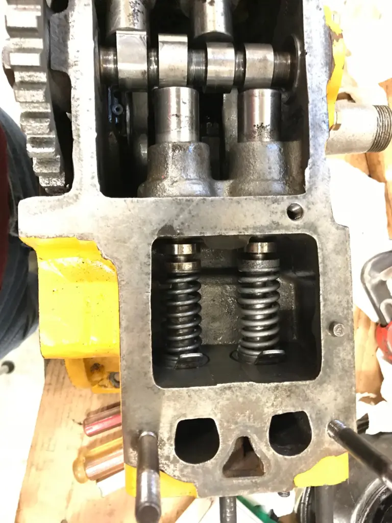

Neil - I was thinking about removing the plug and putting air in the chamber at TDC to see if I could hear air coming through the carb. I did remove the camshaft, but I've checked the timing and everything looks correct (see photos below).

Confirmed that valves rock over TDC. If yours do that, then the camshaft is more or less timed correctly. With the #1 head removed, check that the spark occurs around TDC with both valves closed for that cylinder. Then remove #2 head and check the spark timing there too. Have you confirmed that the exhaust manifold is not blocked? You can remove it, run the leaf blower through each branch of it, and also through the exhaust tube that runs through the diesel manifold. Any blockage in there will prevent it from running.
In theory, if the markings are correctly aligned, then the timing "should" be correct. But the way to know for sure is to check that the events sequence correctly, regardless of what the markings show.

The pony did run OK but it was overheating? In correcting the overheating problem, the timing problem occurred? Doing what Neil suggested should isolate the problem but it sounds like maybe the timing between the cam and the crank is off 180 degrees, Why would I suggest that except been there done that. 😊 The crank can be rotated 360 degrees and the marks will still line up with the cam gear. But if the pony was running beforehand and the crank gear and cam gear were not disturbed, that could not be the problem. The pony will get hot if the main is not turning as the only water circulation in the pony is from the water pump on the main.

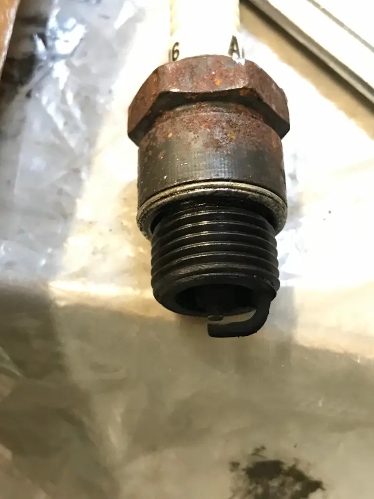

-the title of the thread is pony backfiring... i assume that's back thru the intake and carb? 90+% of the time...that is too lean of fuel mixture...too lean also creates a very hot burning mixture, raising cylinder temperatures...another red flag....
-double check you are getting plenty of clean fuel (filtered) to the carb inlet...and no obstructions thru needle and seat....and proper float level...

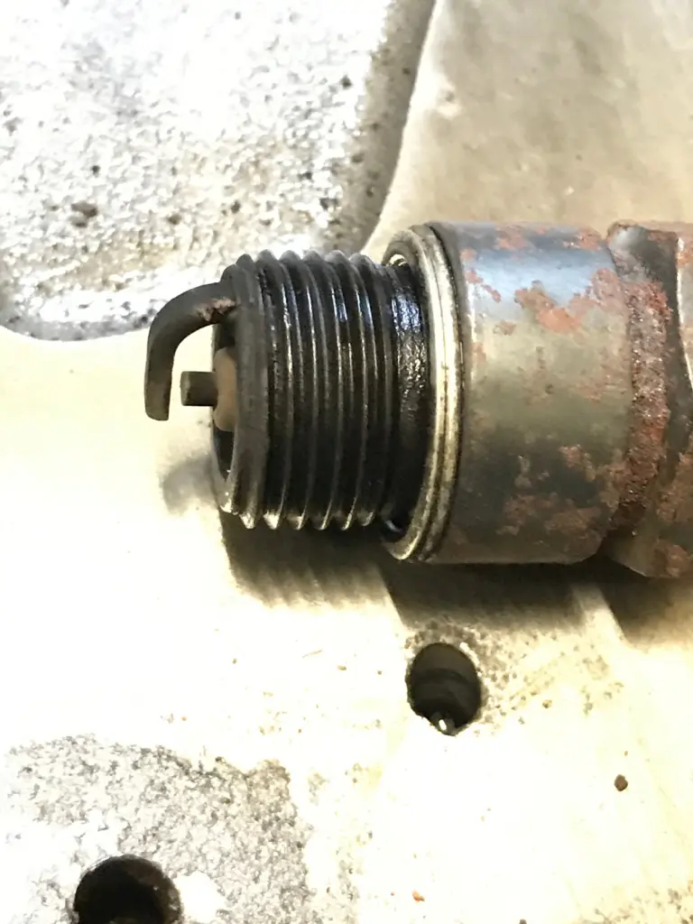

-can you post a picture of the spark plugs....the current plugs you are using?

Kittylover - I pulled the cover from the bowl on the carb and it had fuel up to the jet, and moving the float allowed fuel to flow and stop. Also poured a capful of gas down the carb throat and nothing. Last time I installed it, had a similar problem and it fired when I did this. Found the problem to be mud daubers clogged up the fuel inlet to the carb. I did rebuild the carb over the winter, so it's entirely possible it could be out of adjustment, but it ran fine about a month ago. I'm using Autolite 3116 plugs. Photos are below.

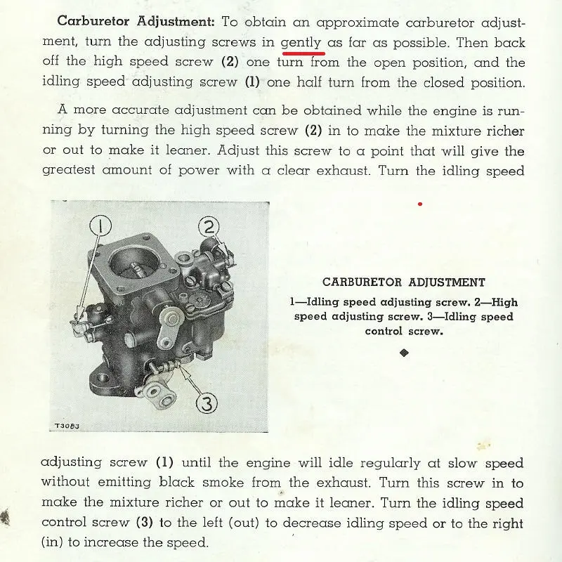

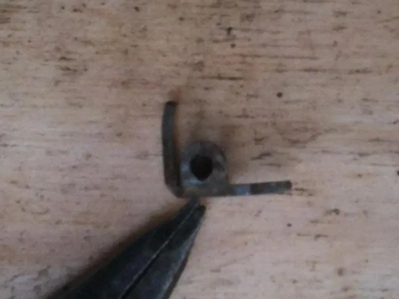

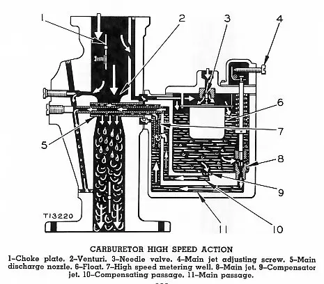

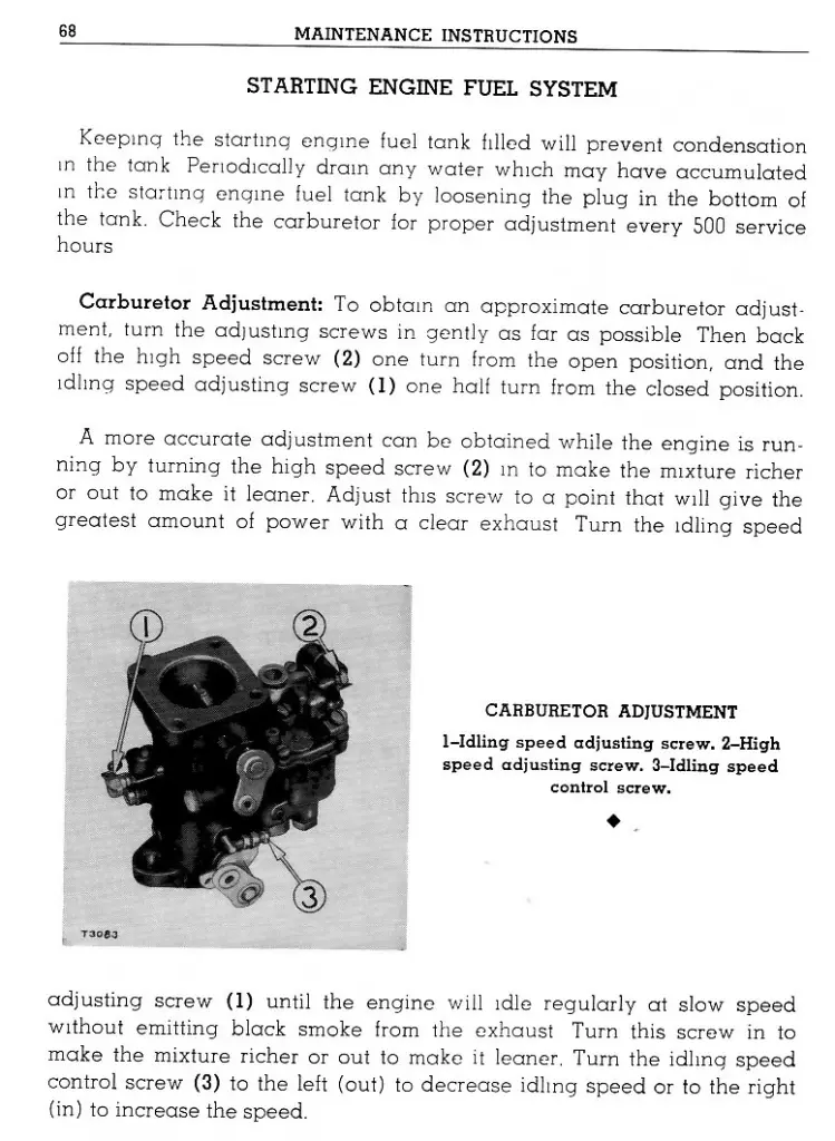

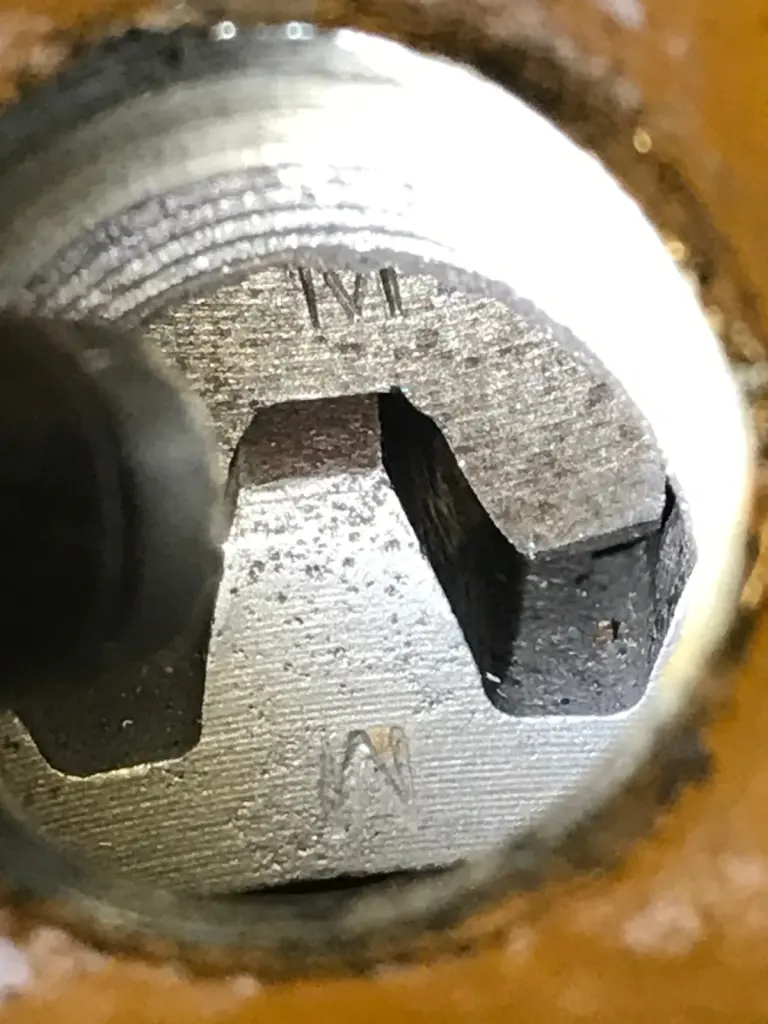

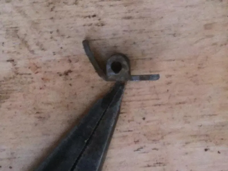

Hi Team,
a too lean of a fuel mixture can be caused by the right angle tin lever in the carby main jet system--this causes a requirement of needing choke to run at full speed and load.
The lever gets bent when too much force is used in the initial setting of the main jet for a first run approximate jet opening.
Be aware that this lever reverses the actions of the main jet mixture screw--in for richer --out for leaner.
Because of the flimsiness of said lever it is very difficult to discern when the main jet screw tops out the main jet at its fully raised opened position--miss the subtle change in screw torque to turn it will result in bending the lever beyond the 90 degrees it should be when in service--this then does not open the main jet sufficiently to get anywhere near enough a correct rich mixture for the engine to run effectively with power and not overheat.
Pictures below should explain clearer than I.
Hope this helps.
