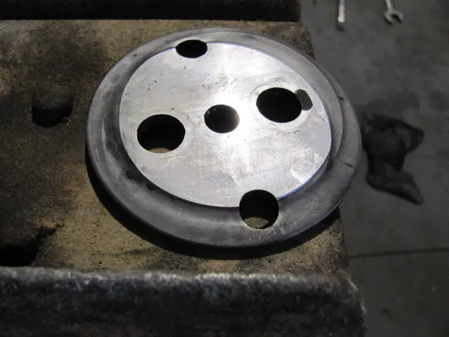

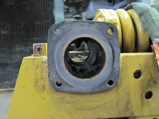

Here are some pics for enjoyment, any help would still be appreciated 😆 like how to get the shaft out to, and what needs to come off. Thanks guys [attachment=22871]image.jpg[/attachment][attachment=22870]image.jpg[/attachment]

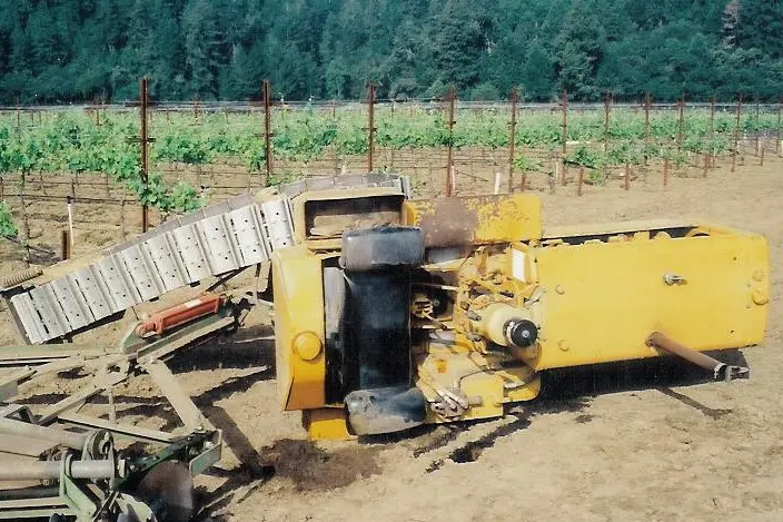

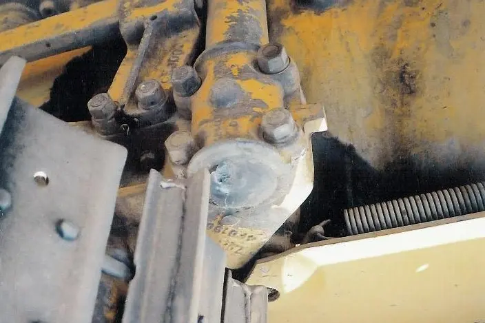

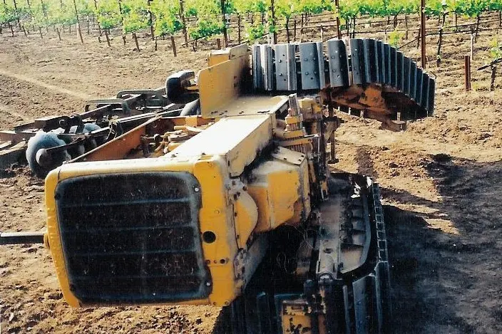

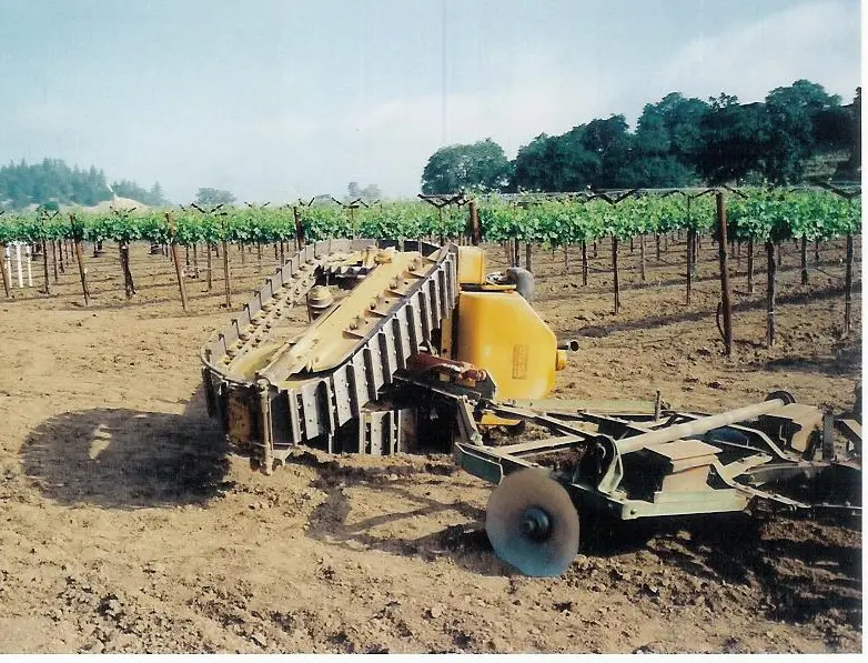

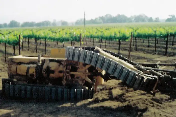

I posted these pictures a few years ago but thought it was worth a repost. No one got hurt. You may be able to see the caps that need to be removed.
Gary
