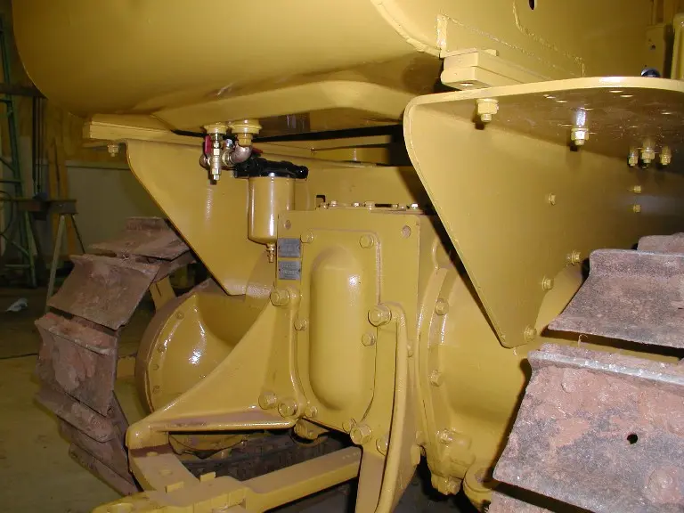

I changed the fuel line on my D2 to AN Braided Stainless Steel hose. Used a short stub piece of the original copper at the transfer pump and then used a compression fitting to make the connection with the hose.
Kevin
D2 5U13247 Direct electric start, #44hyd, 2S blade, Hyster D2N
Thu, Jul 5, 2012 6:21 AM
Cysco
Posts: 870
Reply to n7gxz:
Kevin
Old_n_slo
Like n7gxz I used the original fitting and a short piece of the tubing then attached steel braided line to the tank. Works good for me.
Have a good day......Bill
