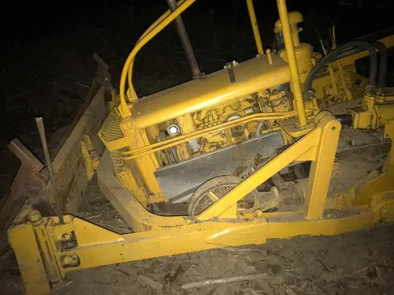

On my 5U I have a 6 way blade and probably about 800+lbs brush rake. Needless to say it is front heavy. Nothing on the back. I've been having problems throwing the tracks backing up steep hills or over rocks and logs. Tracks are adjusted to 2" slack using a bock and 6' pipe to lift track. Should I tighten it up some more? or is this a common problem from being unbalanced and working hard in reverse putting the slack under the track when tipped up on its nose?
Glad I built the new engine brush guards and put the belly pan on, otherwise I think would have been looking to buy more parts.
[attachment=43562]IMG_0676.jpg[/attachment]

yeah, you have it diagnosed pretty well, front heavy and the slack is under the track frame when backing up. you need to find a big counter weight for th eback like a winch. or even fab up a weight box and bolt it on the back and fill with concrete.
i have no idea if it was on d2's or not but some tractors you could change position of the front idlers to high or low position, low for blade work, high for tractor use pulling implements, maybe thy had different diameter idlers you culd get to help keep your arse end on the ground?
that looks like pretty nasty ground your working in, which doesn't help either as the tracks are twisting on the ground a little bit and have less chance to run straight than they would on good hard ground.

You could tighten your track some to help I think. An old joke: old man says" doctor it hurts when I do this," doc says " don't do that". So listen to your machine already!

take that crap off…. its only a d2 and primary designed as a drawbar machine.

if i remember right the spec is 1 1/2 inches sag on the track---the larger diameter idlers are 23 1/2 inches and are made for blade machines
