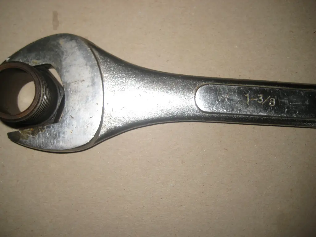

I believe the nut is 1 3/8''. Buy a cheap socket, cut it in half and weld a piece of pipe in between the the two halves. There is an o ring or quad ring at the base.
 [attachment=75853]IMG_2760.JPG[/attachment]
That part number is the same as the nuts in my D8 filter housing and it takes an 1 3/8" socket.

[quote="PhilC post=255874 userid=11059"]That part number is the same as the nuts in my D8 filter housing and it takes an 1 3/8" socket.
Thank you Phil for correcting me... I was relying on information posted on ACMOC years ago by another member. I went out and removed one of the cannister nuts and it is 1 3/8''.
 [/quote]

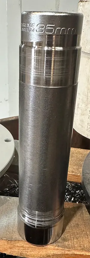

I made this one today out of a 35mm 3/4" drive socket. Seems to be a slightly tighter fit than the 1 3/8 but it was all the hardware store (Bunnings) had in stock.
 [attachment=75857]FIlter Socket.jpg[/attachment]
