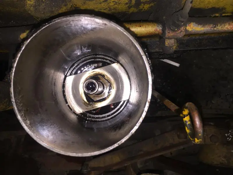

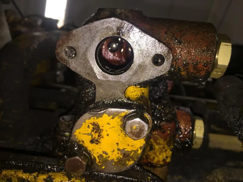

i am working on getting my d2 not to mark it territory and after some thought i taken off the oil cooler and lines. i made up some brass plugs to fit in the holes on my lathe. but not sure what parts i have to take out of the filter base to get the flow right?. with the big hex nut off on the bottom i can see right thought it but i can all so see what looks to be a check vale ball is that what i need to remove ? the way it looks it will have to come out of the top how dose one go about doing that?

Just remove the oil cooler bypass valve and spring.
thank you so much Old Magnet that is just what i was looking for your a life saver. thanks again
