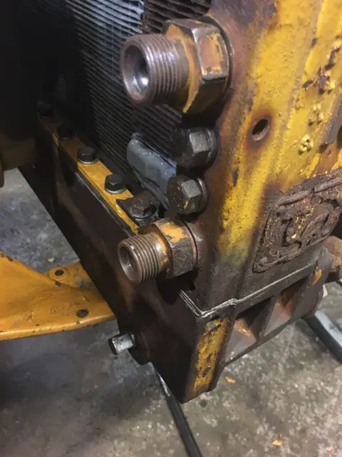

Hello friends,
I am sure there is a post on this but I'm not on my laptop and I am driving around to different hose shops.
What kind of threads/fitting is it on the ends of the oil cooler tubes?? No one seems to be able to see what kind of fitting/thread it is.
I am trying to bypass my oil cooler for the time being to see if my diesel will start, but need to have a hose made in order to do so.
It anyone can tell me what kind of fitting it is I would be very greatful in my hunting to make a hose.
Thank you
Nathan

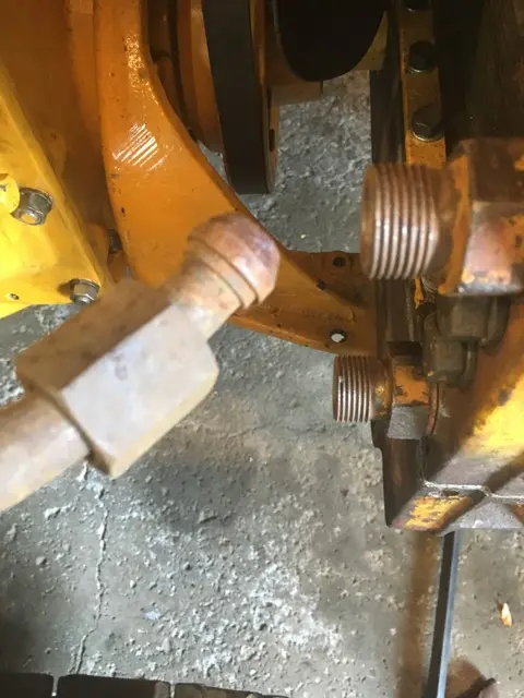

Hi Nathan,
looks to be inverted flare, 1" dia thread 14TPI. Radiator end of tubes is spigot, filter end is socket.
This end inserts into filter housing:
[attachment=43841]IMG_4661.jpg[/attachment]
This end has a corresponding socket on the tube to connect to the radiator:
[attachment=43843]IMG_4664.jpg[/attachment]
[attachment=43842]IMG_4660.jpg[/attachment]

I found those threads to be UNF as in the same as a fine thread bolt of the appropriate size.
I went through the same thing as you are and the local hydraulic and fitting supply stores couldn't supply or identify the fitting.
Found a , I think NPT fitting that was slightly larger and ran a UNF tapping die down the thread and this worked fine.
Only got stupid answers from the blokes at the hydraulic stores.

In an old thread OM identified what it was?
(4 or 5 years ago)
This one! "Get a couple of dash10 Oring Face Seal plugs from your local hydraulics store. Slip a #116 oring up to the shoulder, add your preferred thread sealer and forget about the oil cooler."
http://www.acmoc.org/bb/showthread.php?24069-Question-D4-7U-Oil-Cooler
This will/should get you close to a proper fitting.
One other thread was mentioned to take the fittings you currently have and tap them to 3/8 npt. (he plugged them for a bypass) In your case you should then be able to use 3/8" hydraulic hose on standard fitting.
I believe it was Lance in AU that said it is actually a straight fine bolt thread.
One other fellow suggested leaving the pipes going to the front (old J series) and making 2 small manifold adapter blocks, then brazing a piece of tubing between them. This would allow oil flow from the top port to the bottom port. With the Chaff Guard installed, no one would ever see!
I remember reusing the fittings and using new stainless steel tubing to create the bypass loop on a J series.

I Took the fittings out of the cooler put them into the filter base using the copper washer side in the filter base ,the local hyd. shop had fittings that worked to seal into the flare side that adapted to half inch pipe thread then used a piece of hyd hose to connect.
