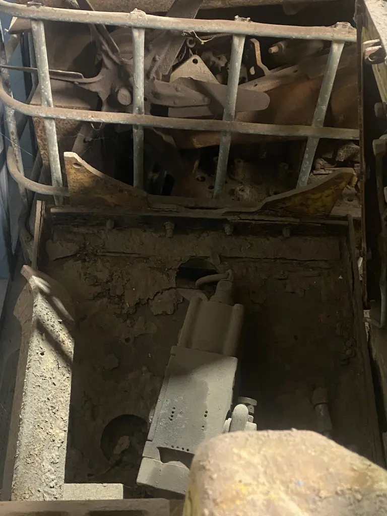

Busso20
Posts: 387
Thank you received: 31
Breadler, I checked my parts pieces only have the bottom plate with out any mount section or bracket looking item (Engine block is sitting on it), ill see if I can get pictures from under my machine to see if they help to locate bolt holes etc

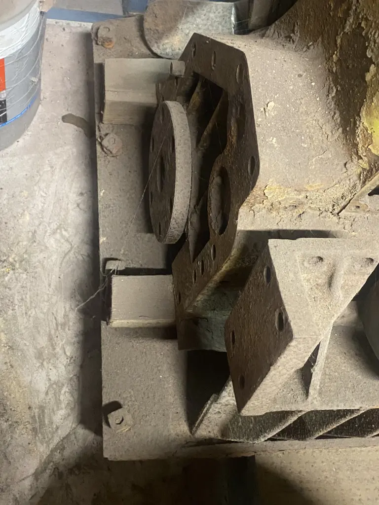

Busso20
Posts: 387
Breadler the first picture I believe is the end bracket you may be chasing measurements from on the U shape bracket, the other end of belly guard has holes only picture in this post
