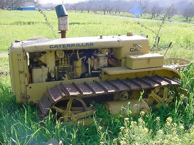

I have located quite a few grouser pads that appear to be the same as what I have on my D2, except they are 20" wide instead of 16". From what I understand, they come off Hardy rice harvesters that were used up in the Sacramento area. Because they were used in the mud, they have very little wear and are in good shape. I would have to cut 2" off each side which is not a problem. Does anyone else know if there is any problems with using these?

Today I took one of my grouser pads and they match up perfectly except for the 20". The hole layouts are exactly the same and the profile is the same. Is there a demand for 20" pads for dozers? I might be willing to trade someone for 16" pads that are in good shape. I need 66 total. I did not even check to see if they would work on mine, but I really don't need 20" pads and would rather keep mine pretty much stock, I have a late model serial number 17,500 and it's an orchard model.

I would be willing to talk to you about that d4e. How tall are the grousers on yours. These grousers are about 1 3/4" high. I will keep you posted willy as to what happens. Thanks all for the interest.
