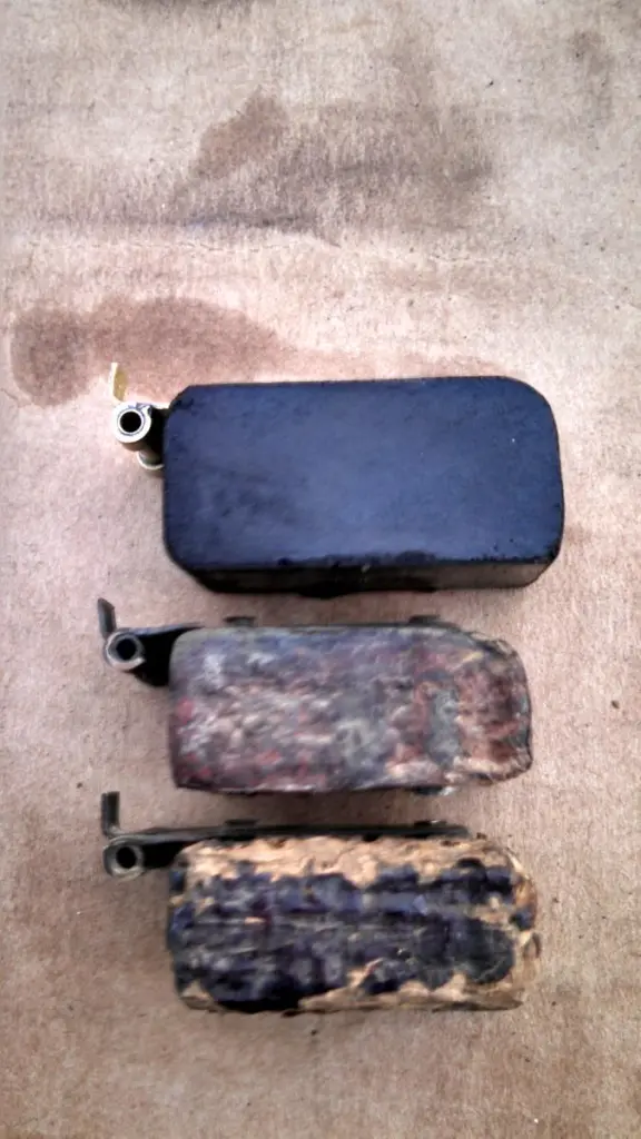

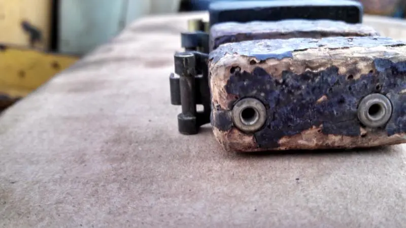

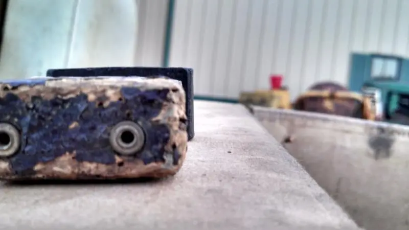

I bought a new float from my local Cat dealer last fall. The float is some sort of squishy foam. I am still having flooding problems. Looking the situation over it appears that the new float is a bit too big. It sticks in the float bowl. I took one of the fuel inlet screws out (the one that screws into the top of the float bowl cover). That let me stick a spray can straw down into the float bowl. Without a doubt I can feel the float break loose when I push on it like it was wedged in the bowl. Once I unstick the float gas will start bubbling up out of the screw hole. I have tried to rebend the tab on the back side of the float to give it more clearance there, but it doesn't seem to help. It seems like the foam part itself is too long and also pretty close on the width. I think if this thing is 1/32" shorter and 1/32" narrower it wouldn't jam up in the bowl. I think the old one is a lot smaller, although it's a cork one that looks like it's been through the war and was falling apart. Anyone run into this before?

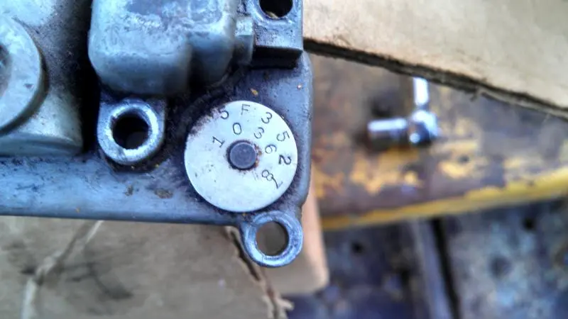

Here ate some pictured of the tag on the carb as well as pictures of the old floats out of my D2s versus the new float.[attachment=23735]IMG_20140604_205500_808.jpg[/attachment][attachment=23736]IMG_20140604_205525_565.jpg[/attachment][attachment=23737]IMG_20140604_205630_583.jpg[/attachment][attachment=23738]IMG_20140604_205809_006.jpg[/attachment]

When I say squishy I don't mean like a wet kitchen sponge. More like the tip of your nose, or even a bit more firm than that. It isn't what I would call rigid, but slightly compressible. I bought two at the same time, one for each dozer. The other float seems to be working fine as the knob is broken off the shut off valve so I can't shut the gas off on that tractor and it isn't flooding the pony (yet). This one seems to be an issue though. If you look at the pictures you can see how much larger the new float is than the old ones. I'd say it's at least 1/8" longer if not 3/16" and about an 1/8" wider.

I didn't compare the two floats when I bought them, simply installed them. It would be nice to see what the other one looks like, but it appears to be working currently so I don't want to mess with it. I think you guys are on to something, however. I left the float out of the carb overnight and it is a lot more firm today then it was yesterday. So, I ordered another float from Cat today, will have it tomorrow. Hopefully I have better luck with this one.
