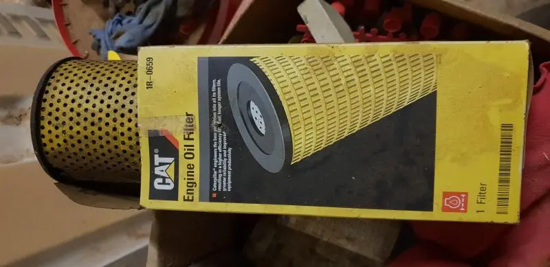

Riverina d4
Send a private message to Riverina d4
Posts: 118
Reply to Cat Yellow1:
Thanks all for the help. Mine is a 1949 model (4U1826).
William Adams gave me this 2 years ago Mike
Hope it was the correct one
Tue, Feb 19, 2019 5:20 PM
Mike Meyer
Posts: 3,333
Thank you received: 5
Reply to Riverina d4:
[quote="Riverina d4"]William Adams gave me this 2 years ago Mike
Hope it was the correct one[/quote]
That's the one, $12.43 plus GST now, the fuel filters are $15.51 plus tax, can't complain about the price of filters from Cat can we, though I'm assuming there will be the 3 fuel filters supplied as 489-3196 plus the filter tower gaskets, the parts number book says that is what comes as the old 7B8262.
Mike
Hi Mike,
Just ordered the same filter yesterday (1R-0659) so still good.
