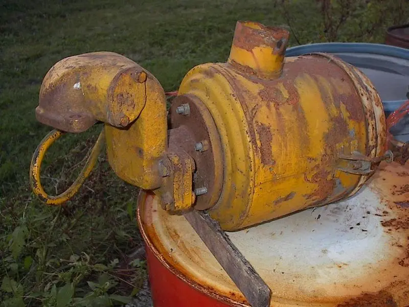

Apparently in the late 50's and 60's there were aftermarket parts available to convert U-Series D2's and D4's to Dry Type Air Cleaners, replacing the old Oil Bath Air Cleaners. In my stash of parts I found some conversion parts.
The first photo shows the D2 adapter. This is not a CAT part, but it is well made by some aftermarket supplier. There is a manufactures tag on the part, but it is damaged and rusty. The tag is marked "1A308" and "Grin...." (I can't read the remainder). Does anyone know who manufacturered this part? Were they common in certain parts of the country? West Coast?

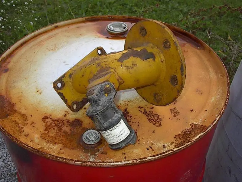

The second photo shows the D4 set-up. There are two parts shown. The gooseneck part is CAT, PN 5F5976. The gooseneck was designed to be used with the Oil Bath Cleaner on special D4 applications. The other part is the adapter to the Dry Type Air Cleaner. The adapter is cast iron, but not a CAT part. Does anyone know who manufactured this part?
Are these adapters available today?
