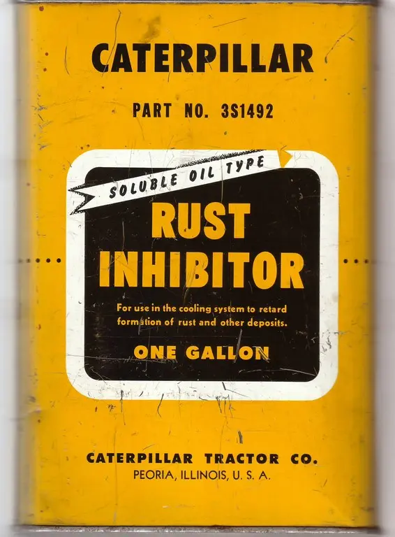

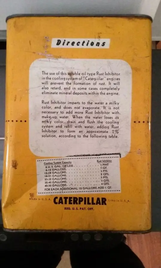

was asked about the soluble oil as a coolant additive last week. I used it in my 2 Ton, RD6, the boss's 2 Ton, Thirty, D4 and D337 when I restored them as I feel it is better in old cooling systems for long term minimum usage.
The new stuff tends to make leaks in old systems--down under where I live we do not usually have to worry about antifreeze so your views and needs will vary.
Also the new stuff, I believe, is suitable for pressurised systems and not recommended for open or atmospheric cooling systems--2Ton, Thirty, etc. for example.
Scans below are of a can of Cat Rust Inhibitor (Soluble Oil) Additive of the day.
I am not sure either if it has any anti-freeze capabilities but some diluted in water and put in the freezer would soon tell.
You can overdose with it and get oily-sludgy residue that could clog the system--I usually err on the side of less is better.
Back when I was an Apprentice, in the days of this stuff, I used to get to clean out clogged systems that were overdosed.
Can be a softening agent on low quality hoses when overdosed.
Hope this helps.

Just looking through some old threads and came across this discussion, Andrew, what brand and type of soluble oil do you use, I've recently tried a small quantity of it in a couple of old tractors following Eddies suggestion and noticed it only took less than half a cup to change the cooling water a milky colour but I see in Eddies photo's of the proper Cat bottle it shows 1 pint of oil per 6 gallons of water as the recomended dose, I was going to buy some next week from the local bearing shop and assumed it was machining oil I was looking for.
