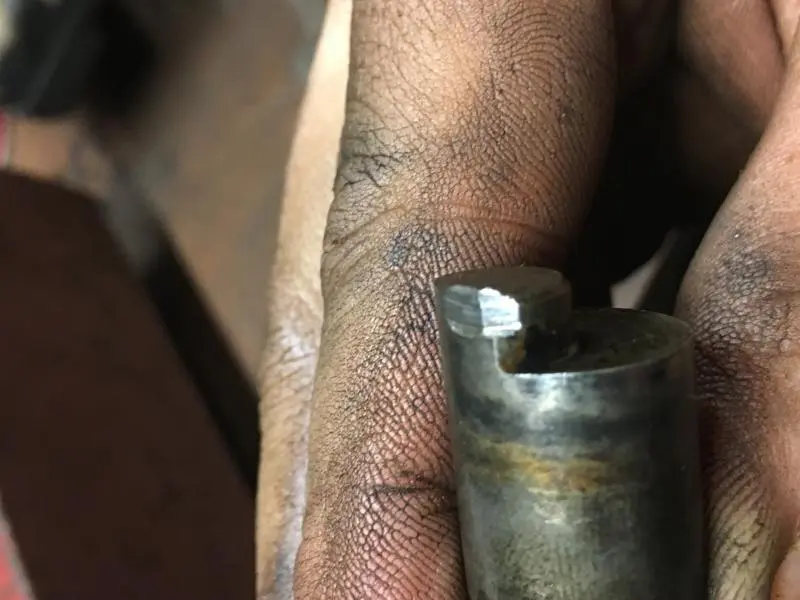

[attachment=47639]IMG_3110.jpg[/attachment][attachment=47639]IMG_3110.jpg[/attachment] I got to digging around with the compression release and there is wear on the cam but I'm not sure if it's enough to make it not work. Could it be a combination of too much valve clearance and worn cams? I've never adjusted valves before but have read the manual on it.
You got it.
Check and adjust your valve clearance. Providing everything mechanical is sano, a proper adjustment will make the compression release work as designed.

Make sure to adjust the valves with the compression lever in RUN (put it in start to make it easy to rotate crank then move back to RUN to adjust). I made this mistake recently when I reassembled the head on one of mine as I didn't realize how the compression release functioned (raises valves) so I had to re-adjust. If that's the D3400 the cold valve lash setting is .012 and hot is .010
Maybe it's possible that someone previous on yours made the mistake I did and that's why the compression release isn't doing anything.

I adjusted the valves and they were way off. Some I screwed in over a turn to get 12 tho clearance cold. The compression release seams to be working now. Next I will warm things up and check them again and it needs an oil change. Thanks for all the advice
