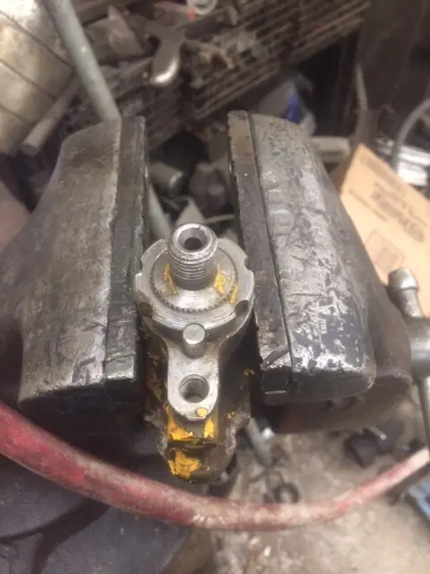

So, how do they come apart? [attachment=53638]pump.JPG[/attachment] I am just trying to get it to run long enough to see if it is worth messing with. If the engine is blown up I am done.
you could try first pouring in some kroil oil or PB blaster and let it soak in a few days. did you make sure you bled all the air out of the system and that the filters are not clogged? what did your pressure gauge read when you were spinning the diesel?

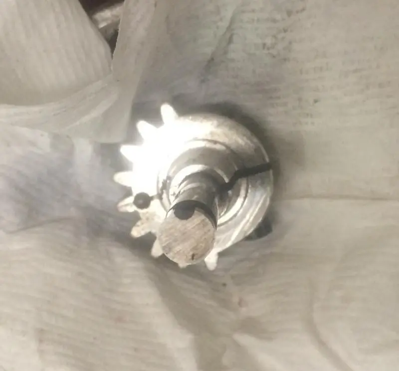

[attachment=53642]gear.jpg[/attachment] This is the gear I am referring too.
yes that is the gear on the bottom of the pump--it meshes with the rack and its rotation regulates the amount of fuel pumped
