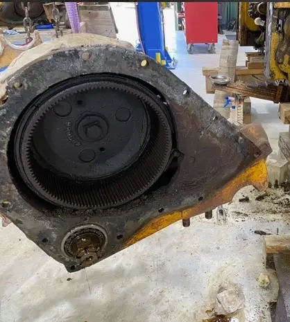

Delta KJ
Posts: 250
The link with the photographs is helpful.  I can see that the brake/steering clutch drum comes off with the final drive, and I can see the brake band in the photograph.  Can the brake band be slid off of the drum while the drum remains mounted in the final drive?
 [attachment=64455]D2 Brake Drum.JPG[/attachment]
Tue, Aug 31, 2021 6:10 AM
Posts: 7,039
Thank you received: 24
Reply to Delta KJ:
Hi Delta,
yes, it's my understanding that you can remove the brake band without having to remove the brake drum, so long as the band anchor comes out no problem. Mine didn't and I needed all the room I could get to cut the pin and remove it piece by piece. I had to replace the drum anyway so it was coming off no matter what.
