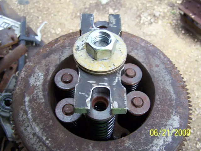

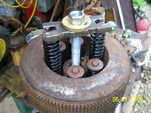

Are there any tips on replacing the steering clutches. I have clutch pieces off the Cat and am ready to reassemble but I have a few questions.
What order do the discs stack on the shaft or does it not matter?
Any tips for how to compress the springs and place the keepers?
I was going to center the discs by sight or should I lay the drum over the inner hub to center the discs then remove the drum and then do the springs and keepers?
Once the inner hub is assembled how do I get it on the splined shaft? I do not have a 3/4 inch impact wrench but I may need to get one. I can just bang on a 3/4 inch breaker bar but I am not sure that would tighten enough.

I made a tool without seeing the tool that was available from CAT. I put the assembly together inside the brake drum to facilitate later assembly. Then when its all lined up I clamp it tight and pull it out of the drum. See the tool in photo's
Jeff
