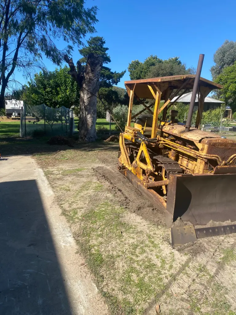

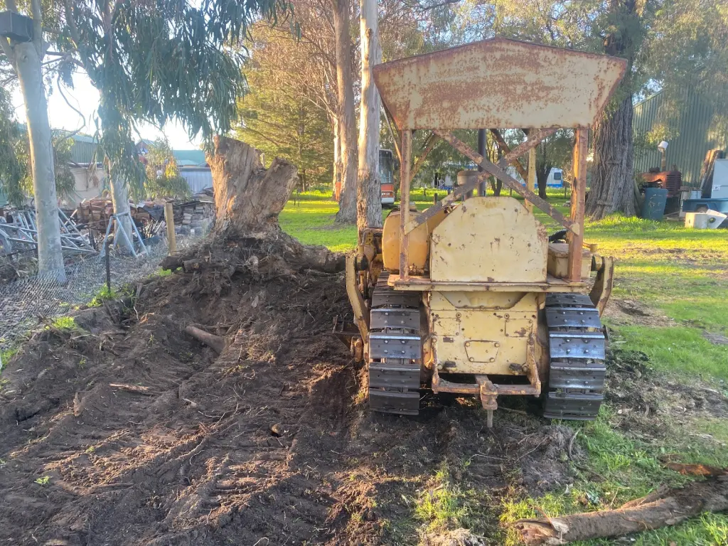

 [attachment=71274]IMG_4867.jpeg[/attachment] [attachment=71276]IMG_4530.jpeg[/attachment] [attachment=71275]IMG_4531.jpeg[/attachment] Hi Wayne, ex works dept number 128, original working condition, new main clutch, adjusted brakes and steering, gauges, runs good, pony good and have spare pony for parts complete, all manuals from works dept, grousers low, chains pretty worn, been shed kept for about 30years that I can track.

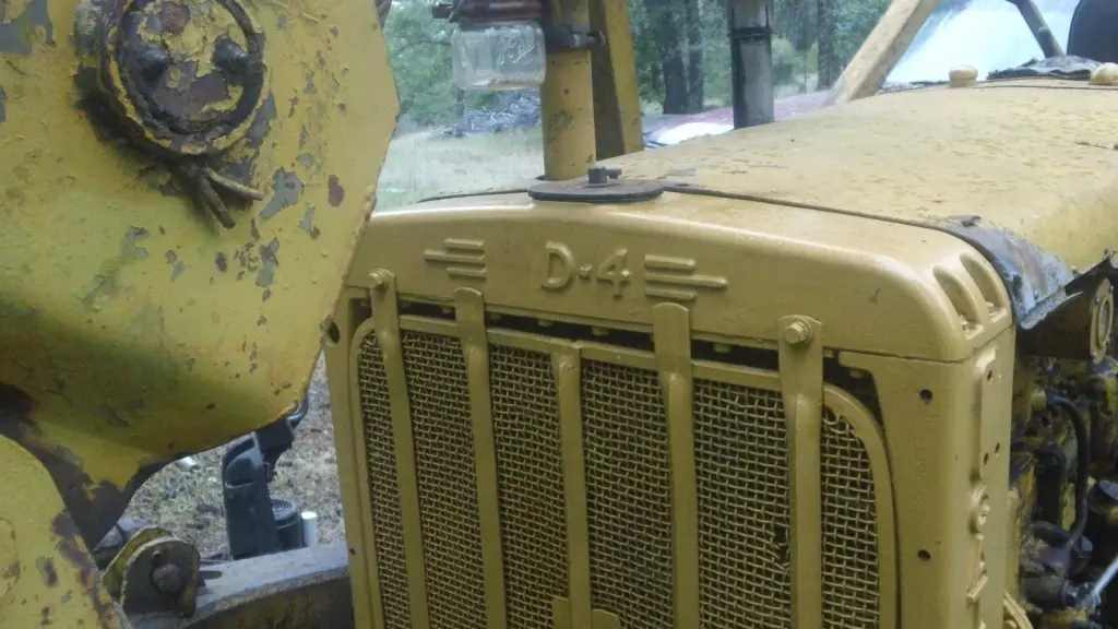

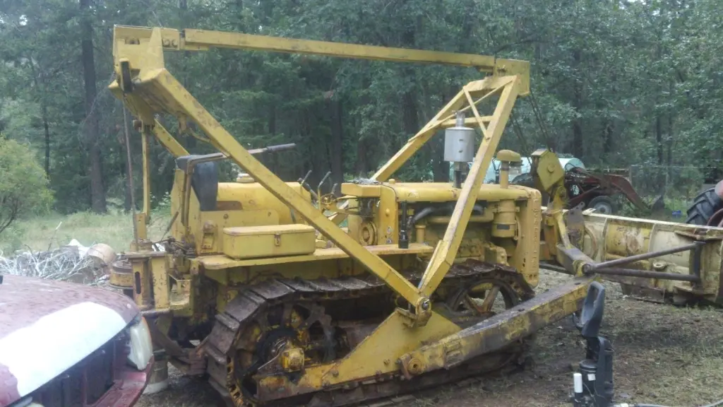

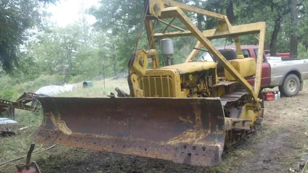

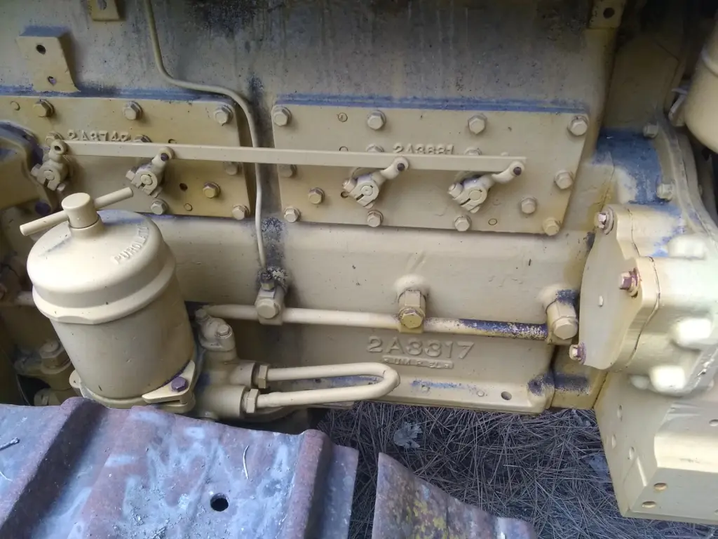

Im new I have a 30s Cat RD4 4G4500 I need A Shot of the Head bolt pattern and torque specs, engine was rebuilt was advised after running for a few hour's to do the last torque process . heres a few pics . I dont have any books yet . hope you enjoy the pics.
