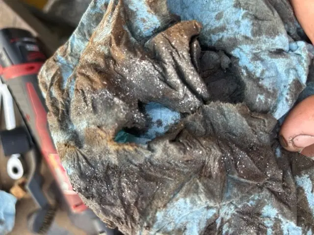

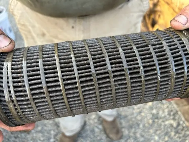

I finally had a little spare time to work the D2 and found a few things that are not good. The fuel system is very dirty. the filters and filter housing had a lot of black sludge in them. Someone added a primary screen filter under the seat and it was full of sludge also. I dropped the engine oil and found more metal than I would have liked to have seen. The filter was the same way. The metal looked like aluminum or lead to me and the magnet would not stick to it. I am at a crossroads now. Do I pull the blade off and drop the pan and check the rods and mains or do I just do an in-frame and put new pistons, liners, and bearings in it? I have yet to hear this engine run. Should I change the filter and oil and try to get it running and change it again after a couple hours?? Any advice?
  [attachment=71351]D2 oil filter.jpg[/attachment][attachment=71352]D2 oil.jpg[/attachment]

If that material is from the main or rod bearings, that calls suspicion on the journal condition. With not too much effort, you can drop the pan and inspect the journals to decide whether to in-frame it or put the engine on a stand to make life a lot easier since you'll want to give the engine a pretty decent cleaning anyway. Also bear in mind that it's possible the source of the particles could be something else failing (not crank-related) like the gears on the front of the engine or maybe the lifters

Yes you're right, I missed that so thanks for the catch. That would rule out gears and lifters and pretty much would only leave plain bearings, such as on the crank or the cam/governor bearings
