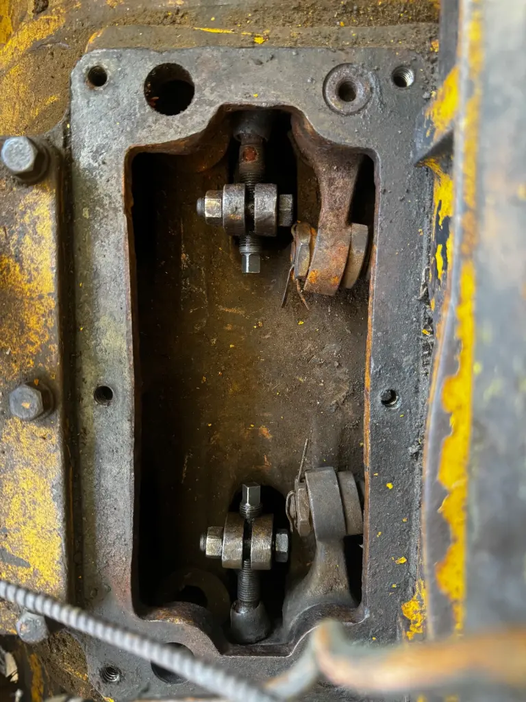

Definitely the right clutch is slipping. Go back and check that you have the bell cranks adjusted properly. There may not be enough free play on the bolt and it's putting pressure on the release yoke. Pictures really help to see what you got under the cover.

Thanks, this afternoon I'll make sure the bell cranks are adjusted properly and see if that helps any. This is my first CAT so I am very new to this machine, I could have easily not adjusted them correctly, that would be the best solution! My D2 is an orchard rear seat model so the diesel tank needs to be removed when ever you need to adjust the clutches and I just put 20 gallons of diesel in the tank.....will get a good arm workout taking it off haha
I removed the left side drain plug yesterday and nothing came out, it was a bit oily when I stuck my finger in but again nothing came out. Will do the same on the right side today. The drawbar was able to swing so dont think that would be an issue unless it binds up.
Sounds like they could be over adjusted; 3” free travel is needed. D2 orchard units are fun! JM

Ok, so I think I figured it out. My steering levers have a ton of slope in them before they start to move the crank arms (not sure what they are called, these are the pieces that adjuster screws makes contact to for each clutch). When I originally adjusted the steer clutches I tried to get the 3" of travel not realizing there was a ton of slope i the lever so I must of over tightened the adjuster screw inhibiting full clamping force to the clutch plates. I backed them off a few turns to make sure they weren't preloading onto the adjuster much, took it for a drive and it turns left! The right steer clutch looks to have some oil on it compared to the left, at least what I could see so will probably be worth doing a cleaning process. Also checked both plugs and no oil/fluid came out.
Now to see why I have so much play in my steering levers, need to read up on them, guessing theres a bad bushing somewhere in the system.
