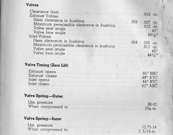

R4Pat - Here's the specs on every valve seat for nearly every Cat built up until March 1953.
Also listed is the dimensions and P/No's of the valve seat inserts for Cat engines. The D2 5U is fitted with the D311 engine.
Valve seat specs - Page 1 ..
http://img144.imageshack.us/img144/6356/valveseats1gv5.jpg
Valve seat specs - Page 2 ..
http://img144.imageshack.us/img144/5364/valveseats2gh7.jpg
Valve seat inserts ..
http://img144.imageshack.us/img144/3368/valveseatinsertses6.jpg
