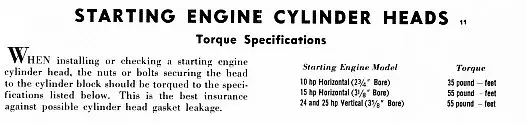

Hi,
another possibility that is easy to check is for a blown head gasket on the pony engine--these gaskets relax after fitment and initial nut/bolt torquing and need to be re-torqued after a few starts and aging after about 20 starts--it is the nature of copper/asbestos gaskets.
You could first try re-torquing if the water entry rate is slow.
To Re-torque back the fasteners of 1/2 of one flat and re-torque to 35 Lbs Feet.
