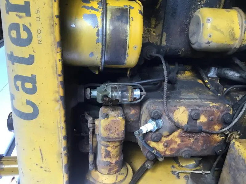

a picture would help, it should have the valve / sediment bowl on it, my guess somebody broke the glass bowl and put that valve in it
I'll try to get a picture this weekend. previous owner removed the sediment bowl and added a inline filter instead.
possible that this valve came from the local hardware store.....
most likely, that was my thought when you said ball valve

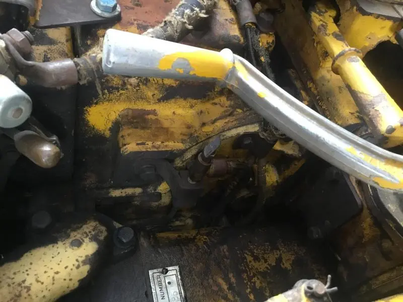

Here are the two fuel shutoff valves on my D2 5U.![]()
Mm nice pics which confirm my second valve is the same as yours and not one someone hacked up...it's a genuine odd looking piece!
