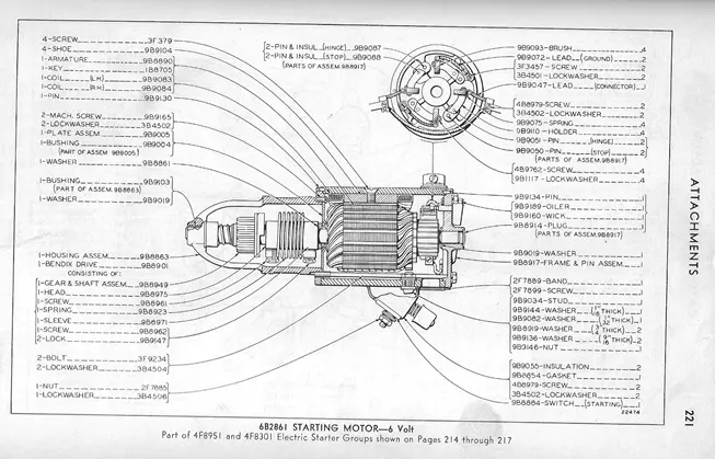

Hi. no its the gear on the electric starter for the pony that engages when the starter spins up.. the electric starter motor pinion that I am wondering if it comes off and is replaceable. thanks

The gear is part of the 9B8949 Gear and Shaft Assem. as shown in scan attached.
