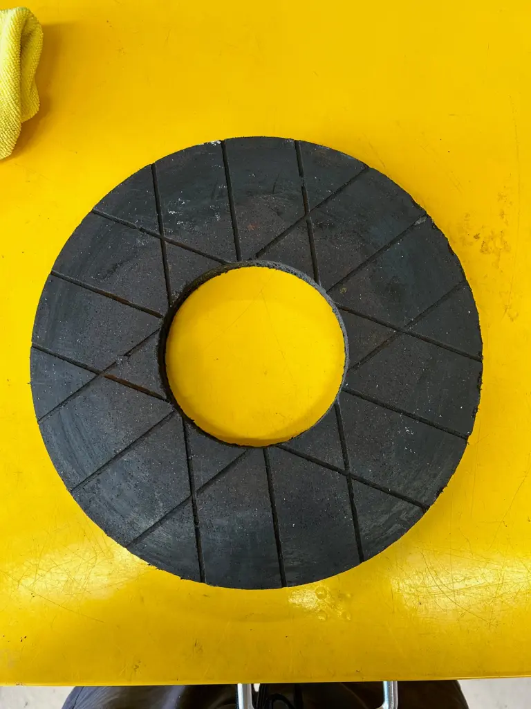

d4angelo
Posts: 338
Thank you received: 6
Reply to n2s3:
thanks for the responses. heard from someone years ago about not leaving the clutch disengaged ,thanks. I will probably need some more help when I get it apart this winter and get a good look at everything.
This is what happens to your clutch when it is not properly engaged. Ask me how I know. This picture shows the missing teeth. [attachment=78054]IMG_2944.jpeg[/attachment] [attachment=78054]IMG_2944.jpeg[/attachment]
Sun, Nov 3, 2024 11:39 AM
rhartwick
Send a private message to rhartwick
Posts: 121
Reply to d4angelo:
In addition to the above, I always thought wear on the pilot bearing was another major reason to engage the clutch while idling.
