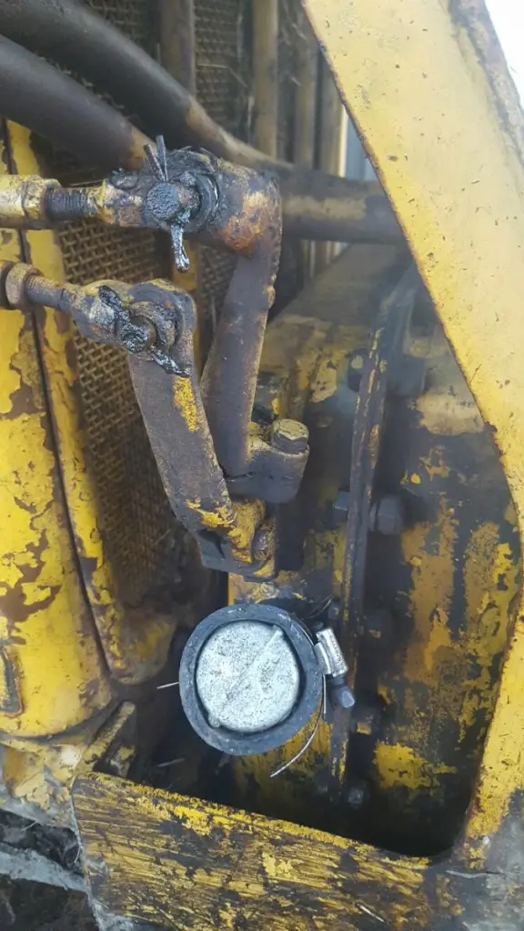

I have a D2 5U with a front mount hydraulic unit. it has 2 levers coming out the right side. one is for the blade lift and the other is for an auxiliary. I am having a problem with the blade drifting down. I rebuilt the cylinders and noticed that if I push the lift lever slightly forward the blade does not drift down. I am assuming that the spool valve is not centering when the lever is released. I cannot find any information on the internals of this hydraulic unit. I think there is probably an adjustment on the valve body to help reposition the spool to center when the lever is in the neutral position. I am hoping to learn what needs to be done before draining the system and taking the cover off the tank to see what is in there 😊 Any insight would be appreciated.

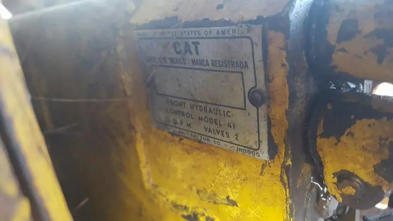

I looked closer at my hydraulic power unit last night. it appears to me a #41 . I assume the valves is similar to the #44. I was hoping to not have to take the front of the tank apart to make this valve adjustment but it looks like I will have to. Thank you.

#41 valves are completely different. Still may be a weak spring. Spool position is controlled by spacers but there is no adjustment feature.
