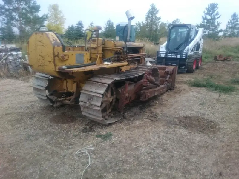

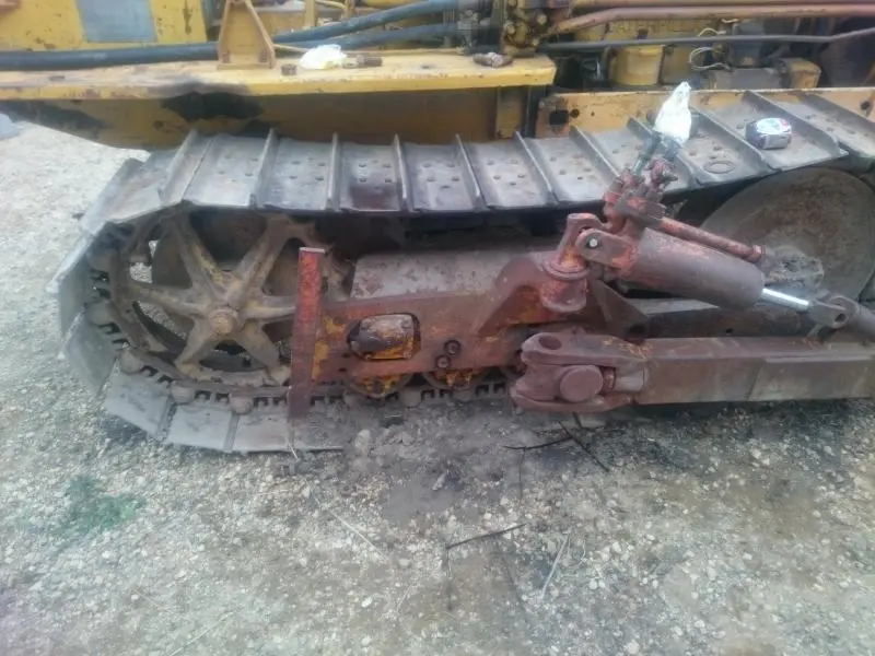

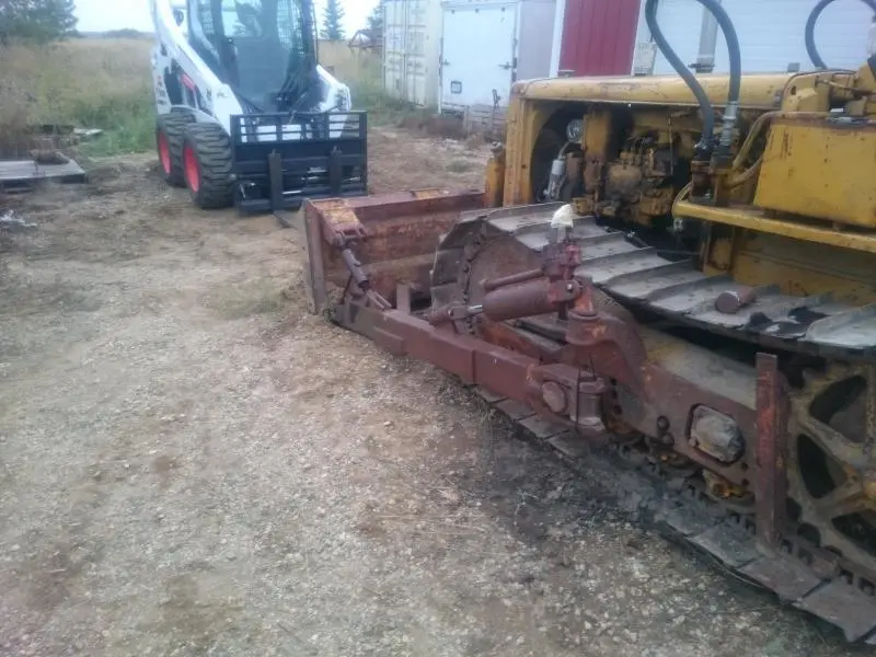

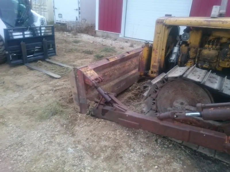

its been a while but back on the D2, we removed the old arm setup and started installing the cat dozer blade configuration, the side plates have a vertical T profile on the back side, at first i figured it was to guide the arms inside face to prevent the arms rubbing the tracks, but they are rear to the arms, what is the function
next the arm pivots/push pin, measuring the hole it comes in close to 1 3/32 diameter distance thro the clevis is 7 inches, anyone have a picture of this pin or actual dimensions it would be appreciated
i know pictures would help, having issues transferring to computer and will add them in the morning[attachment=50516]DSC_0223.jpg[/attachment][attachment=50517]DSC_0228.jpg[/attachment][attachment=50518]DSC_0229.jpg[/attachment][attachment=50519]DSC_0230.jpg[/attachment]

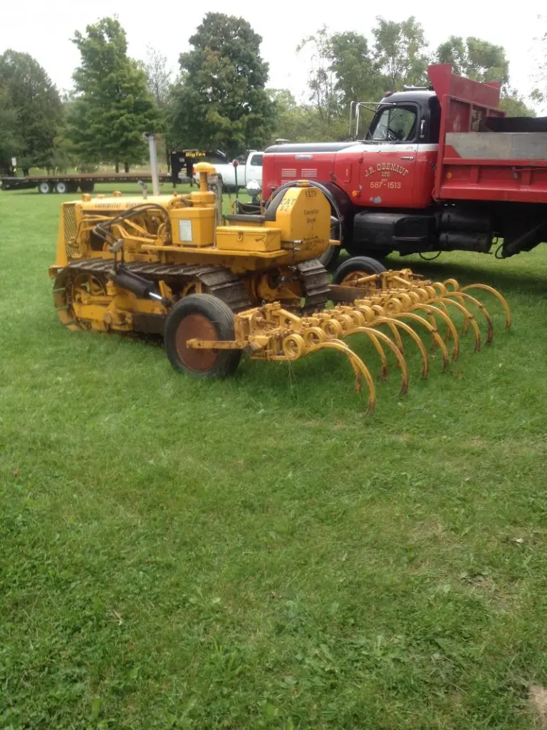

you have a tool bar dozer. the t bars are for when you take the blade off and swivel the arms to the rear. I have a tool bar dozer on my D2 that I use for framing I have three tool bars with different implements. AgMike is the tool bar expert. If I can help you you can call me @ 847-508-737eight

I will be at the D2 tomorrow. I will get some measurements. I have a spring tooth harrow, Cat field cultivator, and a subsoiler.
