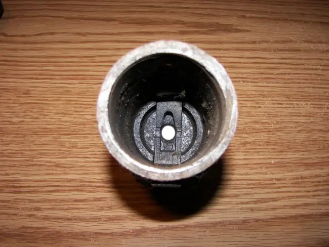

Here are some photos of what the sleve problem I am having. [img]http://www.facebook.com/album.php?aid=23684&id=1278724027&l=a5d9e8a697[/img]

The nose piece/sleeve is destroyed.

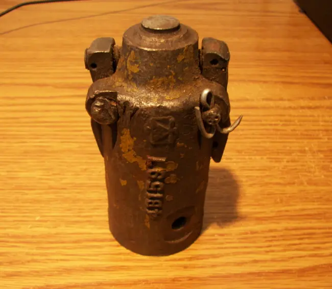

Should look like this:
Here are a couple pics of a 4B1597 drive out of a 5J with the top button and pinion latches still assembled to it. It looks like yours has been broken or worn through from something.
I just check my inventory and am still have 2 sleeve ass.4b1597 and like OLD MAGNET your sleeve is destroyed.
I would be interested in purchasing one . Thanks ever so much for all the help everyone, no wonder mine wouldnt crank over .
