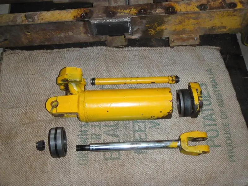

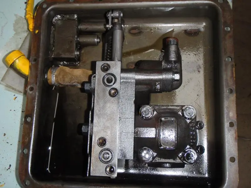

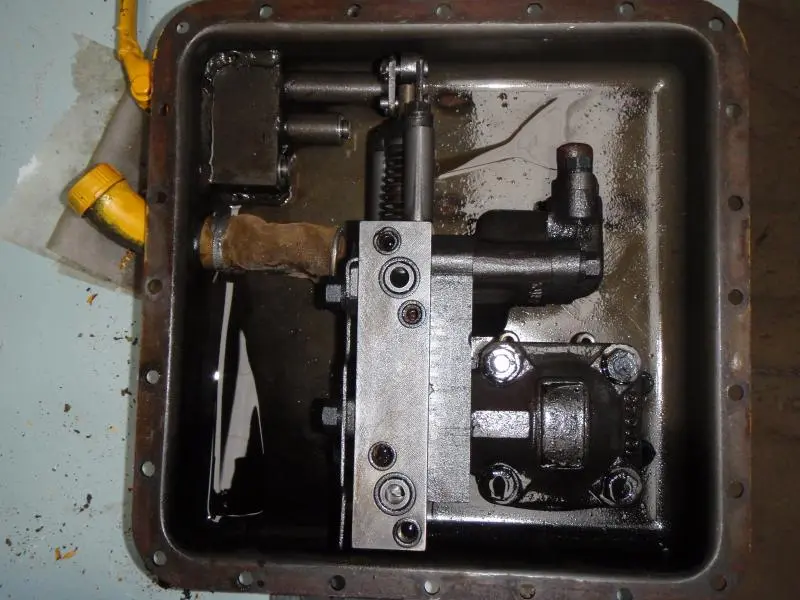

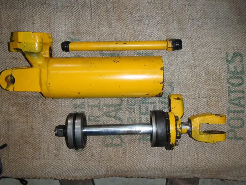

Here are a few photos of the disassembled hydraulic ram and a couple of the internals of the #41 Hydraulic controler.[attachment=15586]PC030218.jpg[/attachment][attachment=15587]PC030219.jpg[/attachment][attachment=15585]PC030217.jpg[/attachment][attachment=15584]PC030216.jpg[/attachment][attachment=15583]PC030215.jpg[/attachment][attachment=15588]PC030220.jpg[/attachment]
Mon, Dec 3, 2012 6:47 AM
Inter674
Posts: 828
Reply to Palmer:
Great photos, thanks
